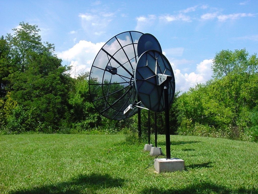

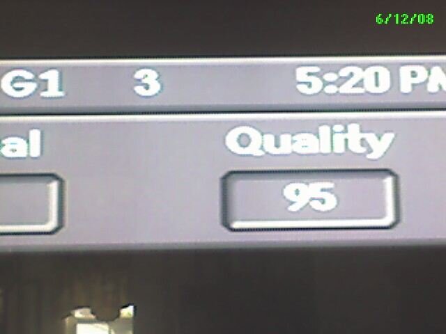

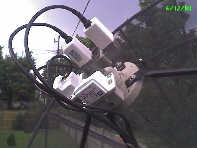

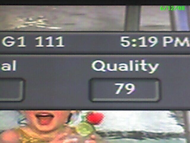

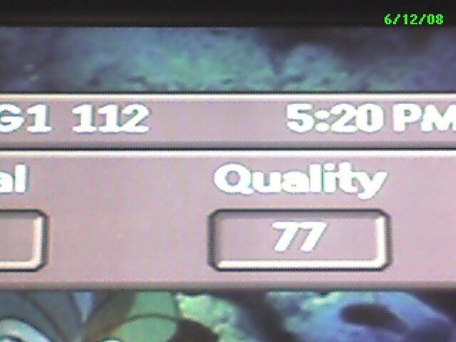

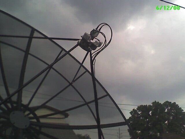

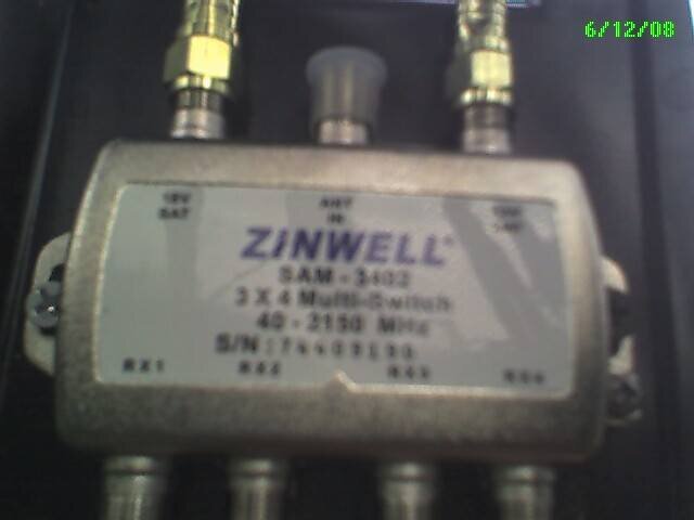

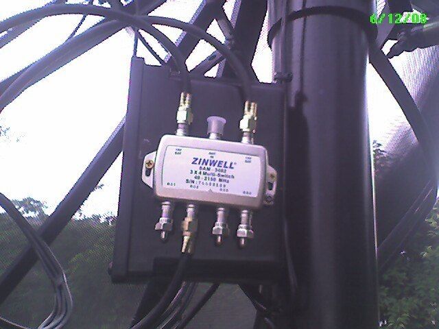

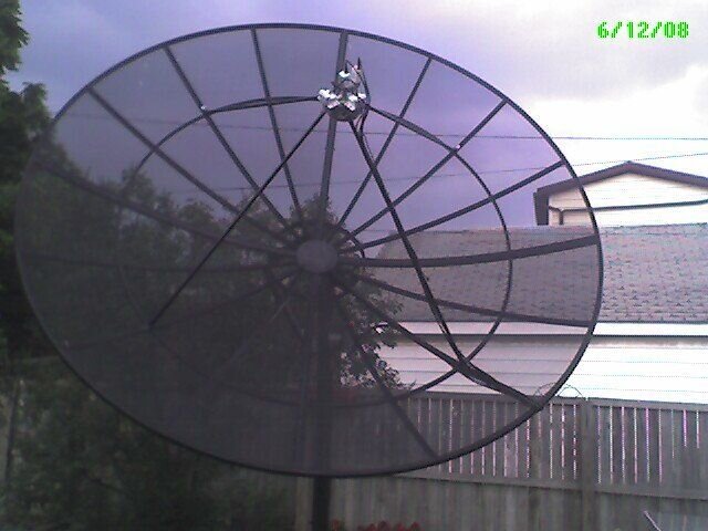

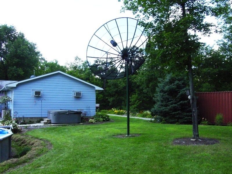

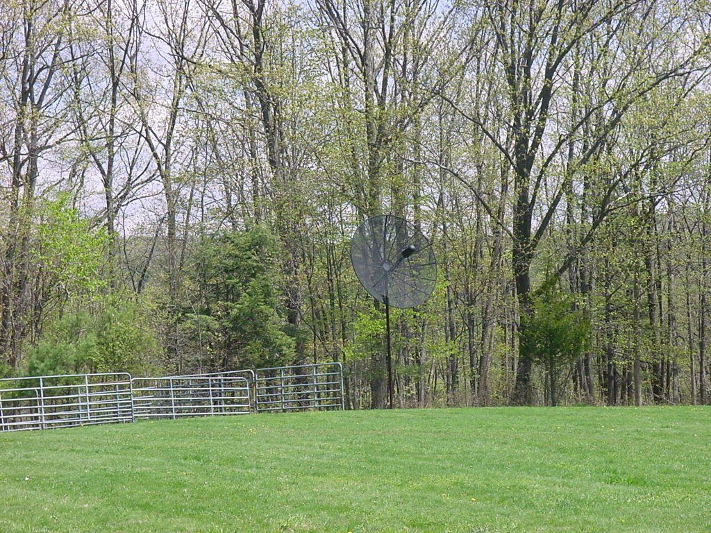

Here's mine:
I have a 10' mesh SAMI with a dual C dual Ku feedhorn (4 lnbs) feeding multiswitches.
This eliminates the need for a servo motor and provides multiple ports for more receivers off the same dish if I choose.
The other dish is a 7.5' sami mesh with c and ku.
both dishes have 36" actuators.
I threw in a pic of my new bike - 2008 Kawasaki Ninja ZX-6R(for the motorcycle crowd).

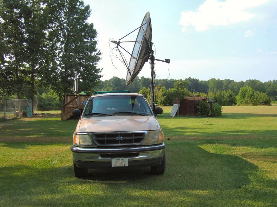

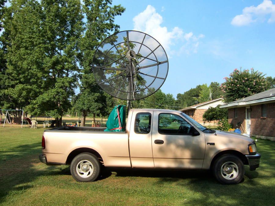

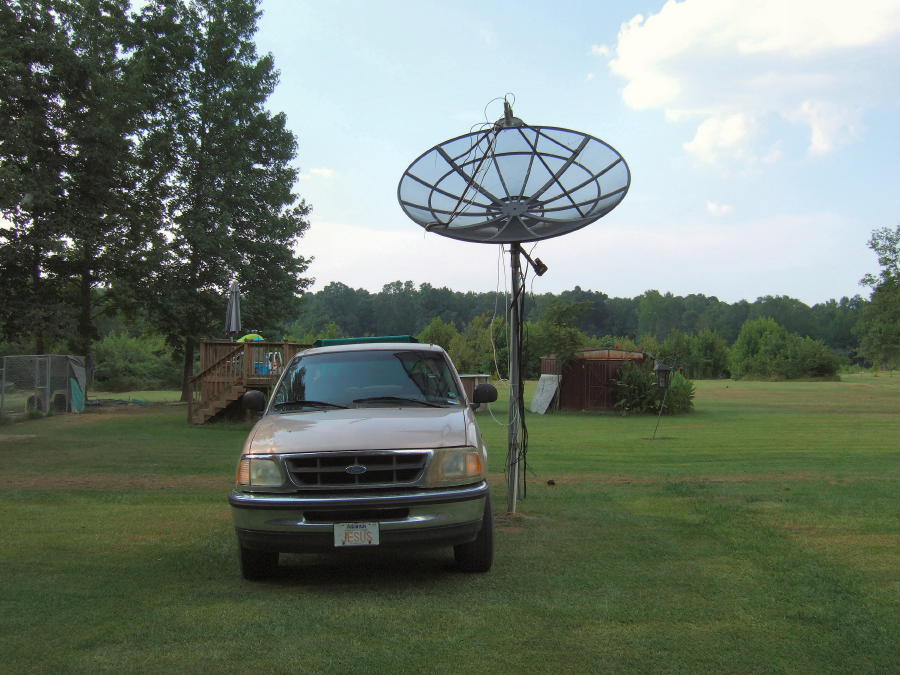

ok here are my photos with my truck parked below it
the pole is 9ft 4 inches to the top of the pole the dish is a 7 1/2 ft unimesh

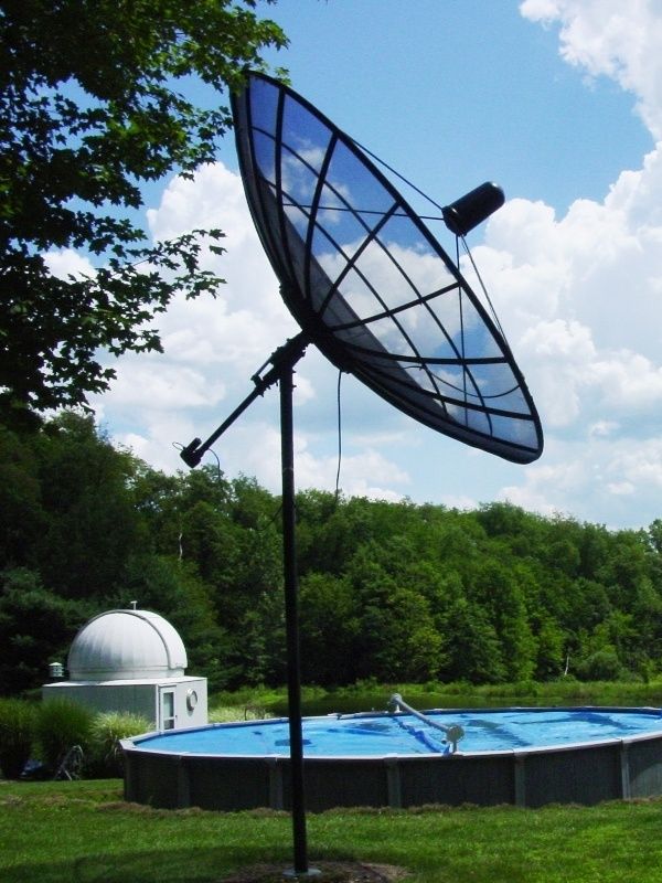

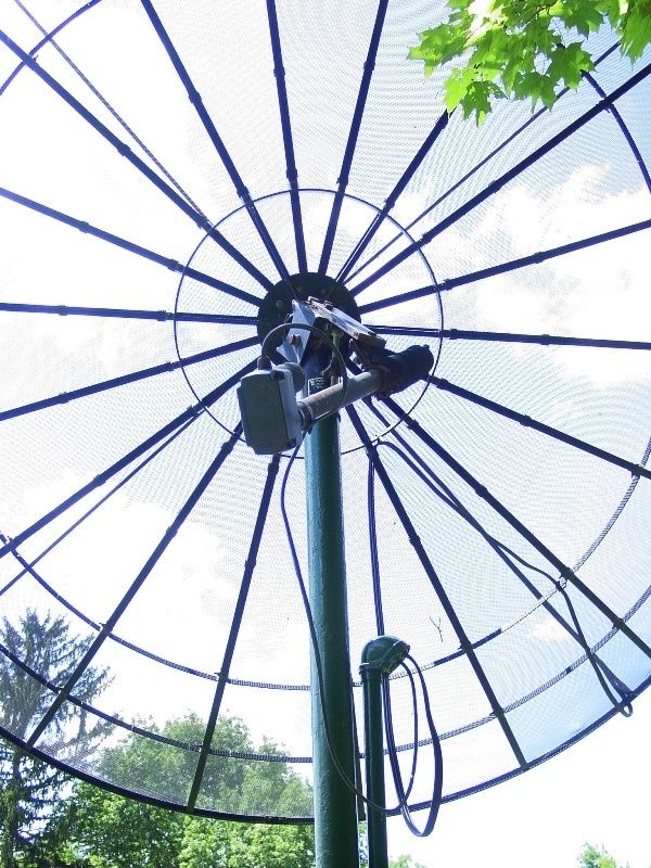

12 Foot Orbitron - High Mount
I installed my 12 foot Orbitron in '91 and it has been in continuous service ever since with only one tracking adjustment (shortly after installation.)
Schedule 40 pipe salvaged from an oil drilling outfit's scrap yard is concrete filled and set in a 5 ft. deep/2 ft. diameter concrete footing. In periods of very high winds it does sway enough to cause annoying signal fading. This could be cured with some relatively lightweight guying, but I've deemed it not worth the extra effort it would take to mow around the guy lines...besides, the whole point of putting it up high was not to overcome any line-of-sight issue, but to provide clearance for the tractor (and to keep it from being used as playground equipment!)
If I were starting from scratch, I would use 24'' Sonotube to continue the concrete pour up for 2-3 feet above grade, similar to the way light poles in commercial parking lots are set, this would considerably reduce wind driven swaying and protect the pole from possible vehicle impacts.

private observatory
Thank you, and yes. Astronomy is my other space-based hobby.

Thanks, Truckracer. The weather head protects and gives an install a nice finished look. Plus, it gives me a place to hide the end of the poly twine I pull through the conduit along with the coax (which comes in handy later if/when you need to pull another cable alongside the original one.)
