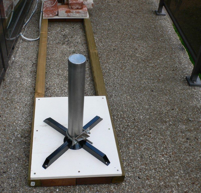

Very interesting dish! Could be Prodelin. Will work good only with original feedhorn, but, I think new LNB could be attached to it. I've made not penetrating stand for balcony out of wood.

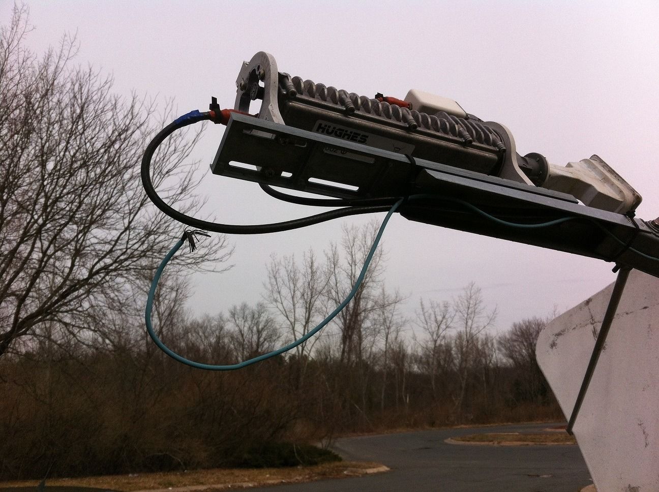

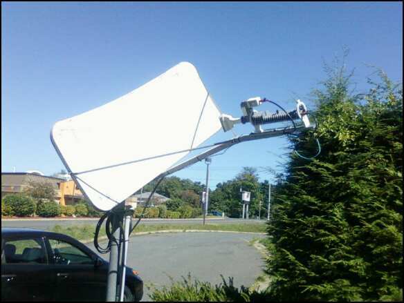

Looks like a Prodlin. The dish is already operating in both V and H. One for transmit, the other for receive. Don't be fooled by the shape of the dish, it's done that way to keep the transmit energy from interfering with adjacent satellites. It already has one lnb mounted on top and can be used as is for one polarity. If you want two polarities remove the transmit module and bolt in a second lnb in it's place. As mentioned you must use the original feed horn as it matches the dish shape and be sure to preserve it's exact position and distance to the dish surface. Here is one I modified for two lnbs slightly different style than yours.
Reactions: Titanium
