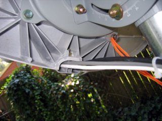

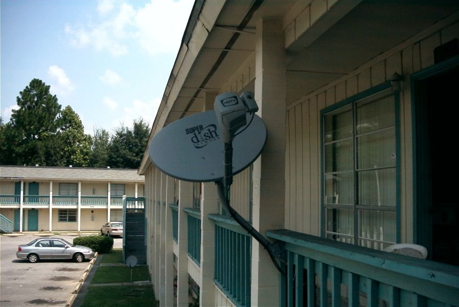

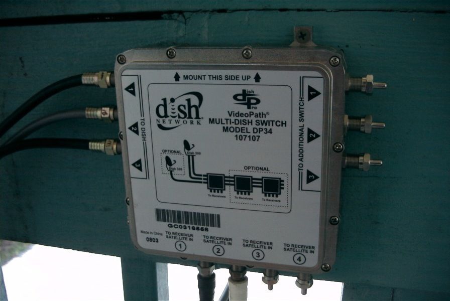

How does the this look?

Cascade said:
Why do you have wires running outside of the arm on the superdish?
If that switch is outside it needs compression connectors.
Only two are, 110/119, and have neat clips running them down the lnb support arm. I did not install it. I guess they could have been run through, I think this was a way for the installer to tell which was which. He used grey cable on one, black on the other. I put the wire ties, which are hard to see by the picture, on after the fact. The switch is outside, but under a balcony!
You cant run the cable lines inside the arm of a superdish, there isnt an opening at the bottom.
Incorrect! I'm not flameing here. There is a 1 inch diameter hole in the end of the arm on mine. The 105 cable is runing through it. The other two could have been run through the arm. I guess it depends who installs it, and then, I do not know how many diferent LNB support arms there are. There may be some without a hole. The clips look like they were made for it, so there again, some might have it some might not. I have seen some around here wire tied, hanging there, ran through the arm etc... So, what is the norm? Probably should be run through the arm, if possible.
