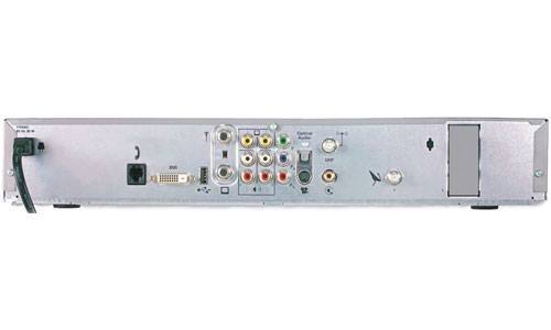

Doesn't Starchoice use these boxes (or at least VERY similar hardware)?
Do they have the same problem, or do they not use the off-air tuner part?
The DSR 550's where remade for StarChoice after Voom demise.
The off air tuner is not used and plugged off on back of the box as well.
If I am not mistaken DSR-550 was exclusive to VOOM. StarChoice uses DSR-500, DSR-505 and DSR-530.
All made by Motorola, similar boxes, different hardware inside (no OTA) and totally different firmware.
That's correct Ilya. The hardware in the Starchoice receivers should however be very similar if not exactly like the Voom receivers. (Of course there is no ATSC cartridge with the Starchoice receivers).
