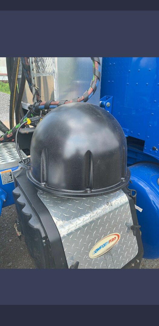

Can anyone tell me if this type of dish will work with an HR24 and if so how do you go about setting it up?
The Winegard RT2035T is a "Road Trip" in-motion dome capable of being configured for the DTV 110 and 119 sats (SD only), the Dish 110, 119, and 129 sats (HD/SD), or the Bell 82 and 91 sats (HD/SD), and is designed for vehicle roof mounting.
DIRECTV satellites 101° or 119°
Unfortunately, if it was the 110, it would be useless.
