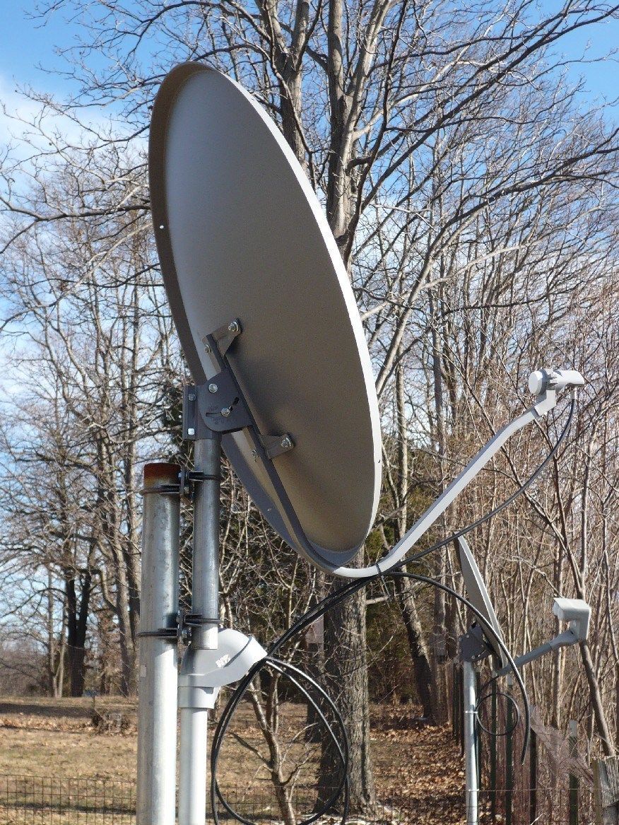

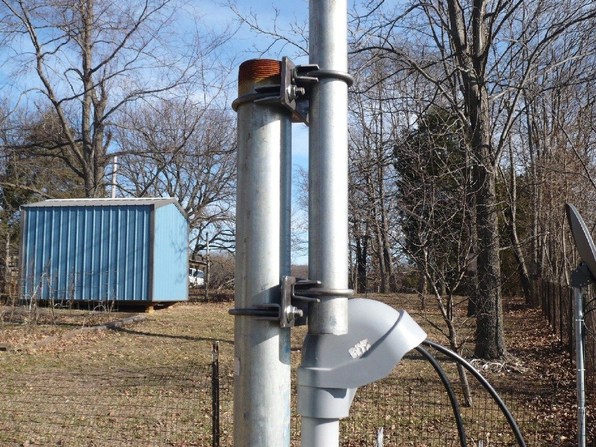

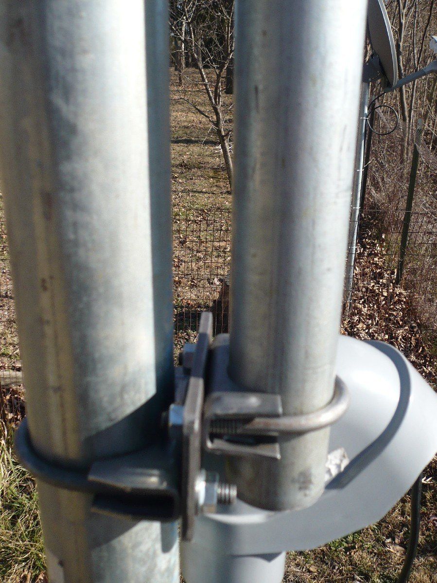

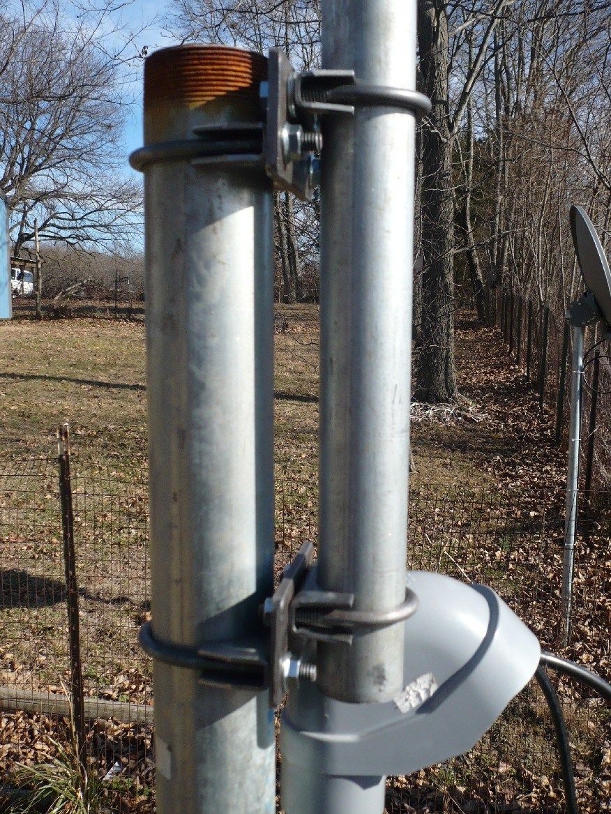

Here is something I put together. The mounting pole is 2 3/8 OD but the Winegard 2076 has a 1 5/8 mount. So I took some 3/16 plate steel and some muffler clamps and came up with this. It actually works pretty good. Even if the pole is not perfectly plum, you can compensate with some flat washers between the back of the muffler clamp and the 3/16 steel. (notice third picure). You can also move the muffler clamp around a bit on the pole
to compensate from left to right. Anyway, thought this might help someone else.

That is similar to how I have my OTA ATSC antenna (1 5/8" mount) piggybacked onto my motorized dish pole (2 3/8"), except I used two conduit clamps, one for each size, bolted to each other.
