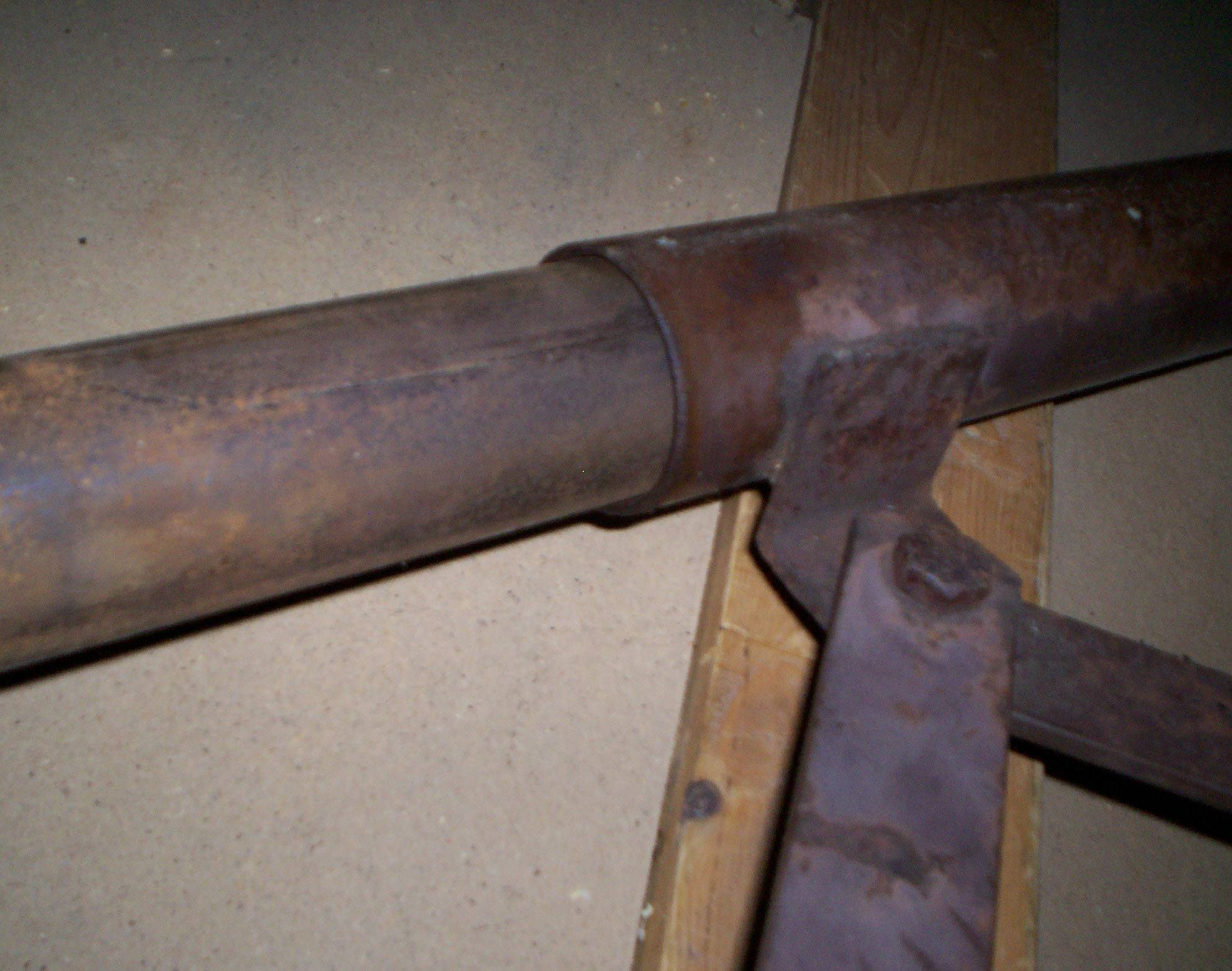

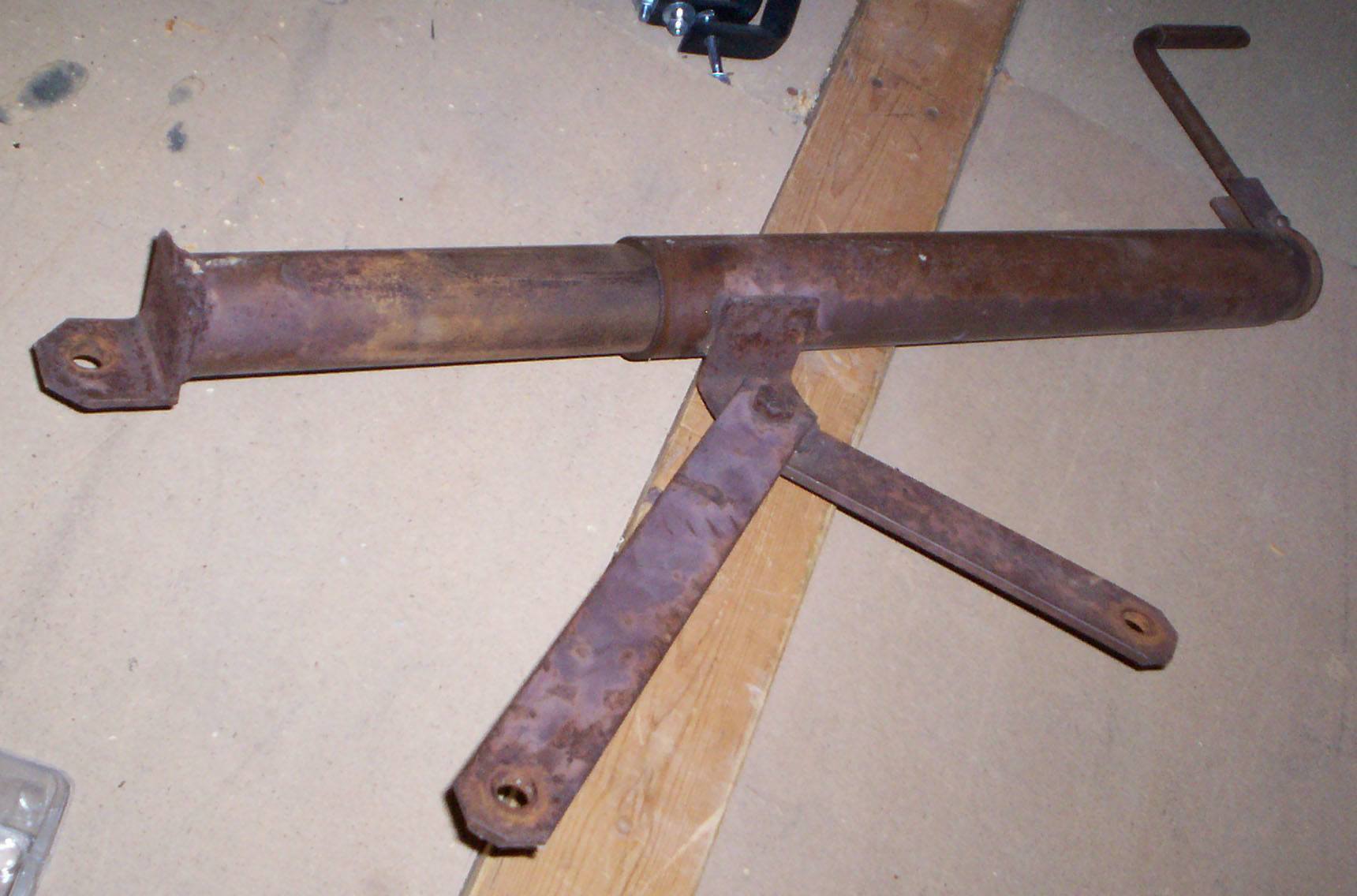

Here's the hand crank I have. It was originally on a 10 foot fiberglass dish.
It actually works very well, even on a heavy fiberglass dish.
Notches are sawed into the inner tube where it lines up with the outer tube for your satellite positions.

Mine had 2 of these Hand Cranks, it's still got the one for elevation on it. The best device ever made (at the time), was an actuator! I had a list, 13 and 1/2 turns to get from Satcom3 to whatever, 26 and 3/4 turns to get from Satcom3 to another one further over, etc., etc.... Made many repeat trips out to the dish to peak the sparklies out of the picture, even in the rain.. Believe it or not, I was slim and weighed about 165 back then. Now I'm fat and weigh about 255, must not be getting enough exercise? Those were the days!!!!
