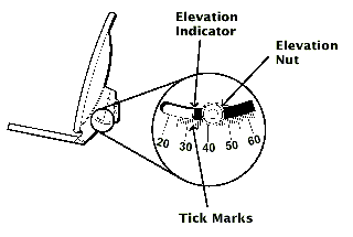

As regards elevation, this particular D500 seems to be
undocumented. The elevation scale lacks the "elevation
washer" shown in some documents, and the flange edge
lacks the red marking described in others.

Put your skew on 90 "straight up and down". Also don't mask the lnbs dont put anything on them you will only use one but the other will be fine. Your angles should be as followed.
true AZ 131.4, mag AZ 126.2, Elevation 31.9
If you look at the elevation bolt you will see right beside it the edge of the piece of metal is were the red line normaly is. See below.
31.9 is very low is there any way to post some pics of the dish?
> beside it the edge of the piece of metal is where the
> red line normally is. See below.
I'd sorta figured that was the case, as the flange
edges are different on the marked and unmarked sides.
