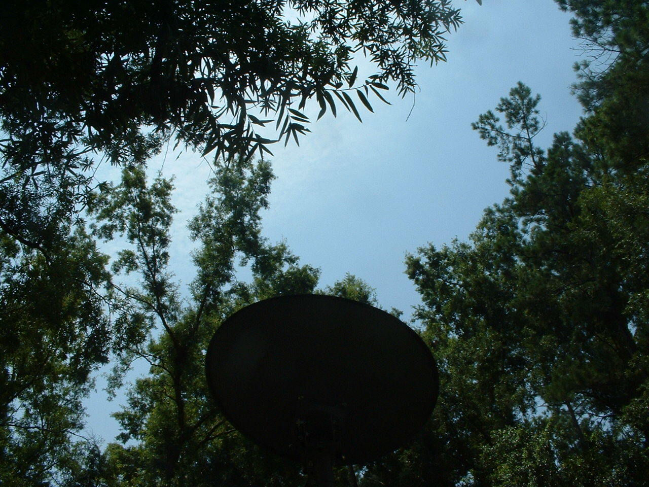

Please help with 119 problem.
igator99
Feb 16, 2006
569
Here is my setup. I'm getting 95 plus on 101, 110 and 87 on 103. I can't seem to get 119 above 50. I raised the dish two inches which didn't seem to help at all. This board has allowed me to do the impossible. I appreciate all input. :)
I went through this about 5 years ago. Raising doesn't really work unless you can completely clear the tree line and that means 20 more feet up. The 119 is low and on the right as iwc5893 mentioned. I betcha signal strength goes up in the winter when the leaves are down. The only way around is find another spot or take some trees down or limbs. Its definately the right side ones when looking out from the dish for 119.
The thing I don't understand is the right side is clearer than the east. Everything worked when the last tech came out. Do trees really grow that fast?

The thing that is driving me crazy and if you look at that picture, I have a clearer shot in the west. Do you guys think raising it a few more inches would help?
No. You have to do some basic geometry and look at the location of the dish, the height off the ground, the distance from the dish to the trees and the length of the triangle from the dish to the top of the trees. Raising the dish a few inches doesnt really clear the trees. It hurts to remember this stuff but you can measure a few things and draw a diagram on paper to see what I am talking about. Now raise the dish in the diagram and you will see. The branches need to go or you need to go a dozen feet up.
The problem is the 119 sat on the east coast. Its really low on the horizon versus 101 and 110. You can have tree blockage at the same height around 101 but the dish clears it because of the angle. Using the same basic diagram, moving the dish back wont cut it either if pointing to the same spot. I wrestled with this and finally lost the battle after moving my dish to 4 spots. The tree blocking 119 had to go and I was right when it went down. Instant signal. At least I know the exact spot in case another one comes back.
Are you on the west coast or east coast? I think we were all assuming you are on the east. That changes everything we posted if you are on the west coast. 119 would be on the left.
They are my trees. I don't think I can cut them down because of the HOA but I could probably get them trimmed. I think they are to high for me to do it. Thanks for the input.:)
