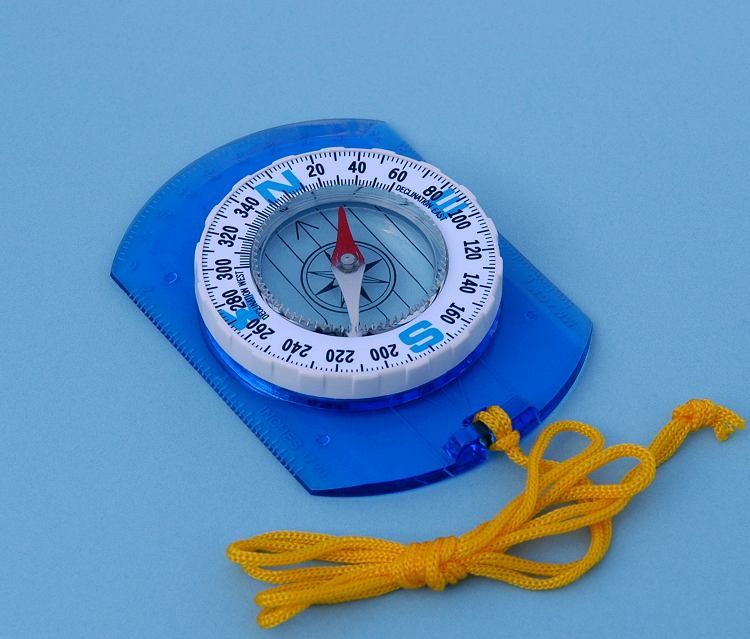

Once you moved it, you more than likely invalidated the Azimuth heading. If you are 110% sure the mast is plumb and level, that is where I would start, as the skew and elevation should still be correct. Do you have a $10 heading compass (aka map compass) to show you where 210° is? If not, I got mine in the Wal-Mart hunting section.

Thanks for the suggestion. I'll recheck the azimuth. do you think that's the reason I'm not getting the odd transponders?
