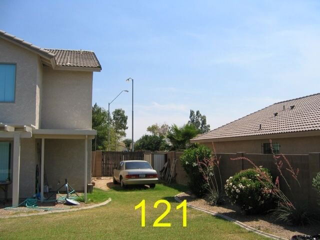

I've not visited the attic in the new house yet, technically I do not own it yet papers still in the works and construction is not 100% yet.
Danger aside the roofline on the new house is 30-40 feet up I don't have a clue how to get up there to mount things! Do you rent scaffolding or a lift of some sort? There is no access to the back yard except a standard small gate in the side yard, block fence all around. I'm not against doing it myself if I can find a good safe way. The property is not big enough for a ground mount and a pole mount seems unlikely also. I've been mulling this over for some time now, just don't see a reasonable way for me to do it.

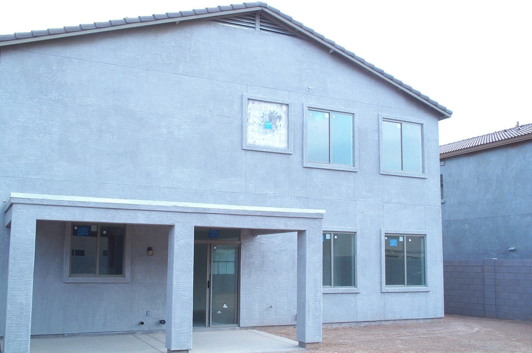

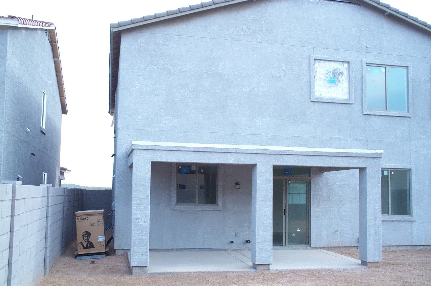

attached a couple photos of the back of the house I'm looking almost due south in the first photo.
I figure I need to do my FTA dish as close to the peak as possible to see the arc without the roof blocking some, as far as I know there are no structures protruding from the roof on either side of the peak looking towards the front.

In that case I would rent a "cherry picker" for a day, or rent scaffolding, OR buy a real good fiberglass extension ladder. Any of those is going to be cheaper than to pay a "pro" installer who probably knows much less about our hobby (and equipment) than you do. As for the danger part, use a safety harness, just dont secure the rope on the other side to your SO's car, you could become a darwin award candidate ;-)
I see what you mean, its a non standard install to say the least! I am very comfortable with heights so for me hiring a ladder would take care of the height issue, but I have no experience with tiled roofs. I always try to keep dish as low as they can go.
What about a pole mount, located down by the wall behind the A/C
It could be reinforced as it would have to be high enough for the dish to see over the wall! There should be virtually no difference in line of sight between ground level and apex of a roof when you are pointing at satellites so high in the sky!
Pity the house was not the other way round as that small roof would be IDEAL for a simple non-pen flat roof mount!
Having seen your house I understand your concerns. I see a possible problem wth an non penetrating mount, as the "rocking" action of the mount (caused by wind) on a tile roof could damage tiles. This is a small appleid force, but could cause a problem.
You could do an eve mount on the front of the house, BUT you will have to heavily reinforce the area the mount is placed.
I would do a pole mount on the back of the house, with the pole mounted to the back wall, and the dish looking up over the roof towards the front. I have seen BUDS mounted this way, so I am sure you can do it
for your 100 cm dish.

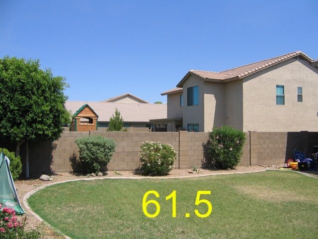

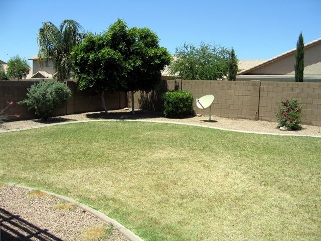

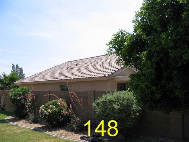

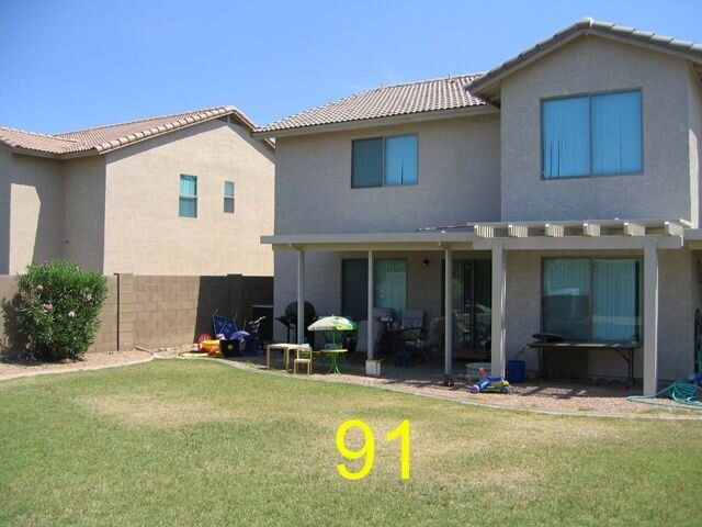

FWIW, my house is situated on the lot exactly like yours is and is also two story.
I did a pole mount against the north wall of my property. I put the pole about half way between the centerline of the lot and the West wall to allow for LOS to the East. Judging by your pics, you should have room to shoot over your house.
The downside to this install is the l-o-n-g cable run between the dish and the cable box. I say downside because 'as short as possible' is generally the rule of thumb. Mine works fine with a 200' or so run of cable (along the fence and around to the East side of my house where the cable box is).
As an added bonus, unless you have a view fence the HOA will never know about it :).

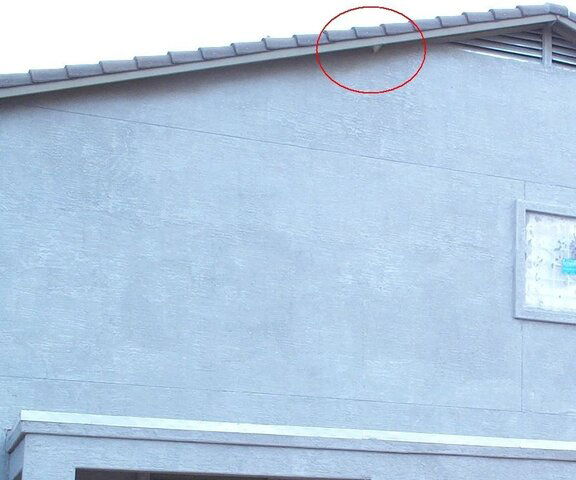

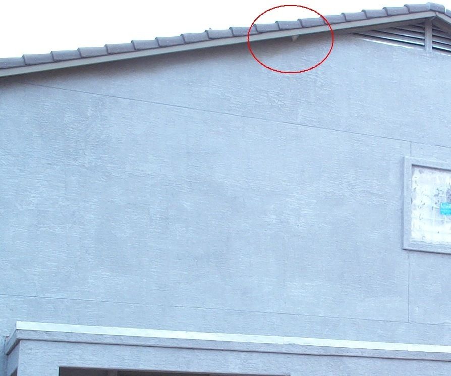

Pics from my place:
Pic of the dish is from my Patio, facing NorthWest. I was able to get down to PAS9 (58w) with that setup.

I appreciate all the ideas and encouragement!
Maybe I can do a re-inforced eve mount 2/3rds of the way up using a ladder from the covered patio. The house isn't true north/south oriented I think it faces between ten to fifteen degrees west of true north/south. I'd like to get as high as is reasonable my current install has been plagued with trees growing up into my line of sight. Though this is a new build and a new neighborhood you never can tell how long it will be until the neighbors palm tree grows up blocking your favorite satellite.
I also like the idea of having the dish low down on a pole at the back of the yard so I can tweak and poke at the alignment, though I think I may not be able to get good sight/signal due to limited lot size. I can probably use my existing primestar on my test pole/mockup to see if a ground installation is actually a workable solution.
I'd be willing to bet that dish/dtv would mount a dish on the eve at the east side of the house. I'll have to do some driving through the area and see if anyone else has dish's up already. Just so happens that the laundry room with the distro box is located on the second floor about 15-20 feet from the back corner on that east wall. making cable runs from that side very short.
