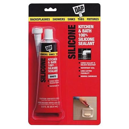

Seal the seams up. Silicone caulk is perfect for this, as if you ever have to get back inside, you can peel it back off without too much work.
