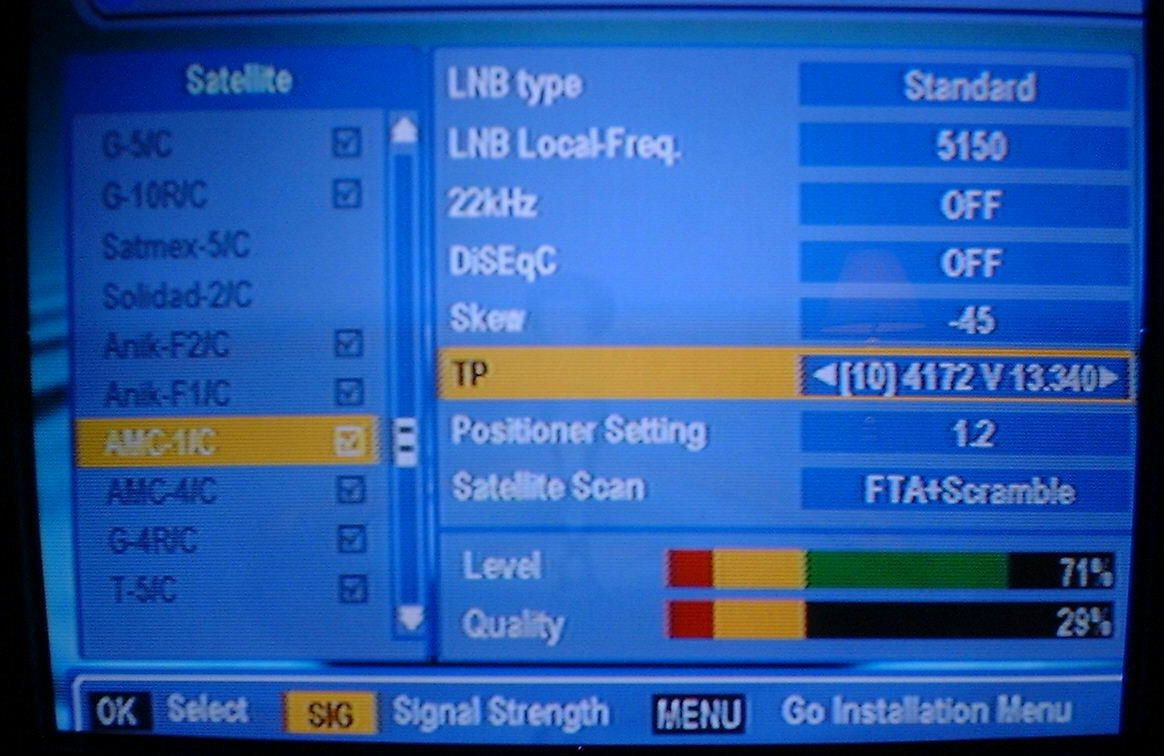

D W on AMC 1
Im not real smart on this stuff, but I will try and help you out. I have found DW on AMC 1, it comes in weak, appearently due to video compression. On clear days it comes in well. I use the LNB setting of (standard 5150) . If you use the (Single SL) setting, you will be able to use the set-up page for dish pointing. The data on the install page are factory set, used with Single SL setting. I will attach photo of data page screen, using Standard 5051 setting.

I still had no signal with your setting.
