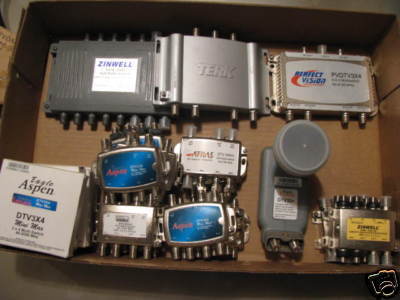

Actually, I've run either port by itself, and it has worked fine. Once I get my "box-o-multi switches" in from eBay all should be well.
