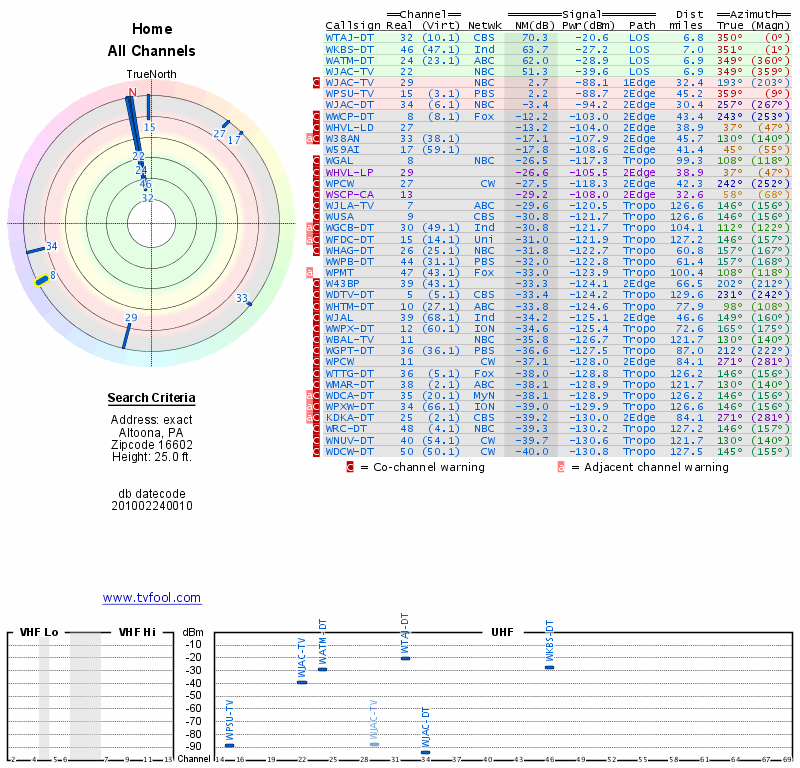

I've been struggling with picking up anything but 10.1 and 47.1 in my location. I have a CM-3020 Long Range with a CM-7777 Preamp. Here is an image of the stations I should be receiving. I'm stumped!

You have 6 possible stations unless the 3020 is in the attic. (Fox does not look promising though) That antenna should work well for 1, or maybe 2 TV's.
The 7777 amp will do more harm than good as close as you are to so many TV & FM stations. The Winegard HDP-269 would be the only pre-amp I would recommend for your location. (If one is truly needed)

3 & 6 are gettable UHF stations, but even the best VHF antenna would have a tough time getting 8 reliably. You may be better off with a roof mounted UHF only antenna since Fox 8 is iffy at best. The 91-XG is probably your best bet for UHF only. (Very low wind drag, & only 6 pounds) A less expensive alternative would be the Winegard 9032.
So an antenna like the 91-XG with a channel listing (High gain across entire UHF band (UHF channels 14-69)) Should be able to pick up down to 3.1 and 6.1? That is where I guess I'm confused with the antenna selections......

At your distance and the signal strengths your TVFool report suggests, you should have not trouble with the top 4 stations.
