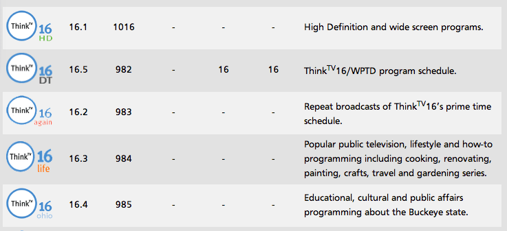

Here's WPTD's channel line-up. Note the channel 16-2:

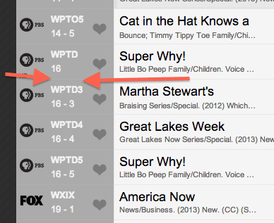

Here's what the remote-accessed-guide is showing. Note channel 16-2 missing:
On the actual receiver, it reads "16Ag" over and over in 2-4 hour blocks...

Haha, I reported 16.2 as being incorrect back in June/July of 2009 ! I was even in contact with the CE at the station, who tried to contact Dish to fix this. WPTD shuffled channels around when they flipped the digital switch and it's been wrong ever since....
