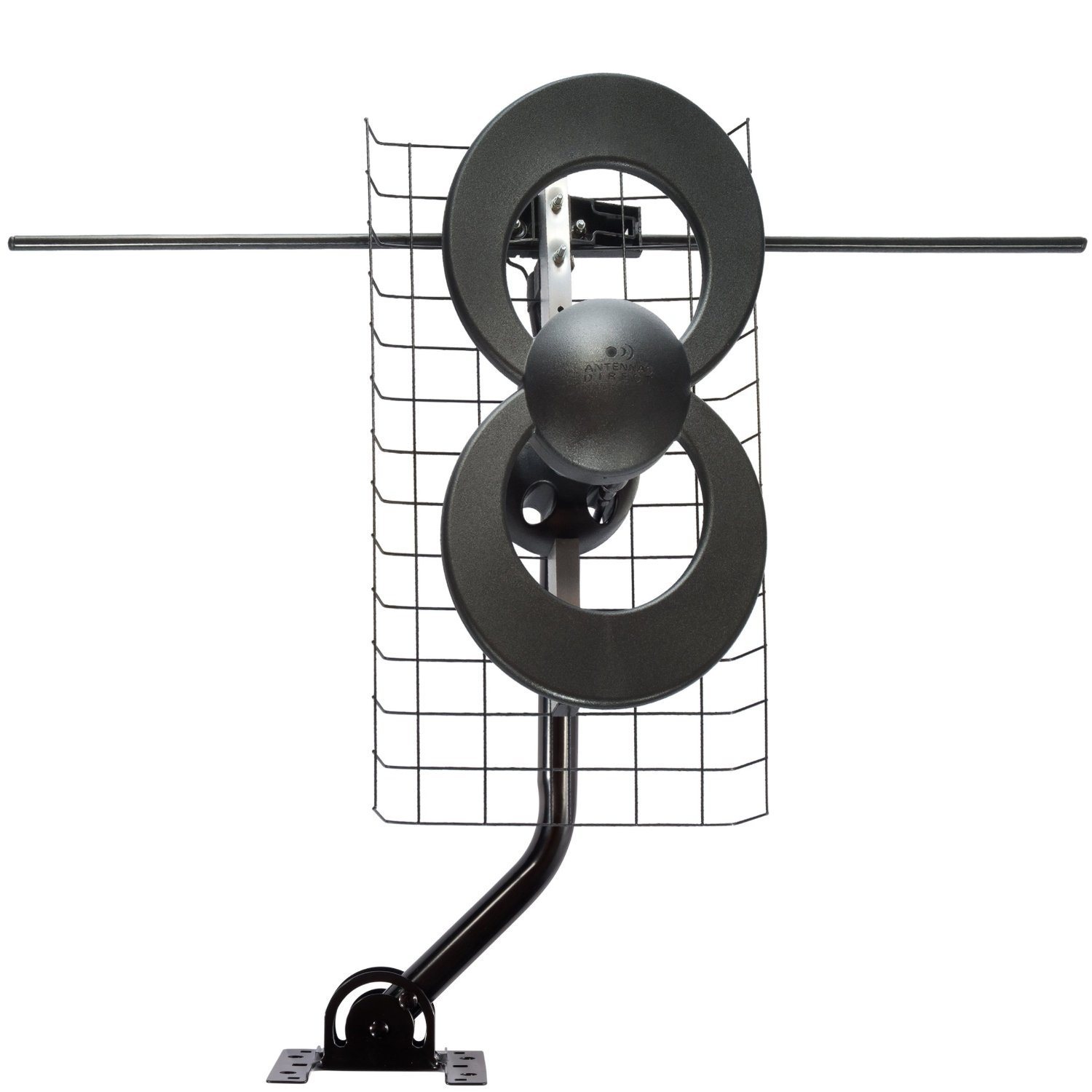

Anyway I picked up the Clearstream C2-V-CJM (I need the VHF) at BestBuy and I'll try that, plus I ordered a CM7777 to see if that does if helps.

Well the Clearstream sucked. I'll try the CM7777 when it get here.
Look at what you bought does the single VHF element look anything like a "rabbit ear"? The uhf section is a 2bay bow tie with the bowtie modified into a circular "bow tie" it looks fancy and high tech so a fool and his money are soon parted.
Compare to a Winegard HD 1080 at $29.99
