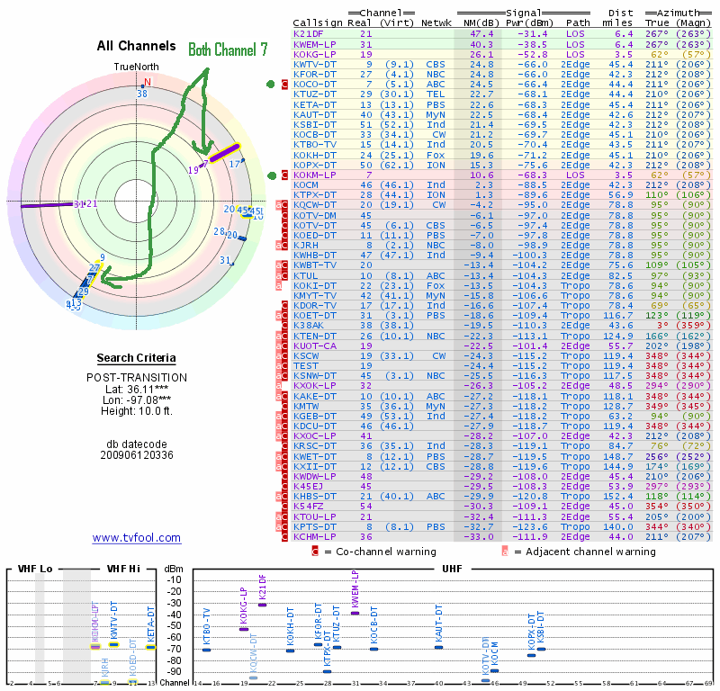

Well, The one that is only 3.5 miles away from me has a very small broadcast radius. However, it is located in the same town I am located in. The attached picture from tvfool.com helps explain this.
(I edited the attached pic. My additions are in green.)
:EDIT:
I called the company that owns the small broadcast tower that is close to me and they said they have never heard of this problem before and that I should pick them up loud and clear on channel 7. My dad who lives about 20 miles south of me does not have this problem. Is there something I'm missing here?

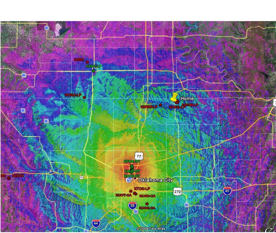

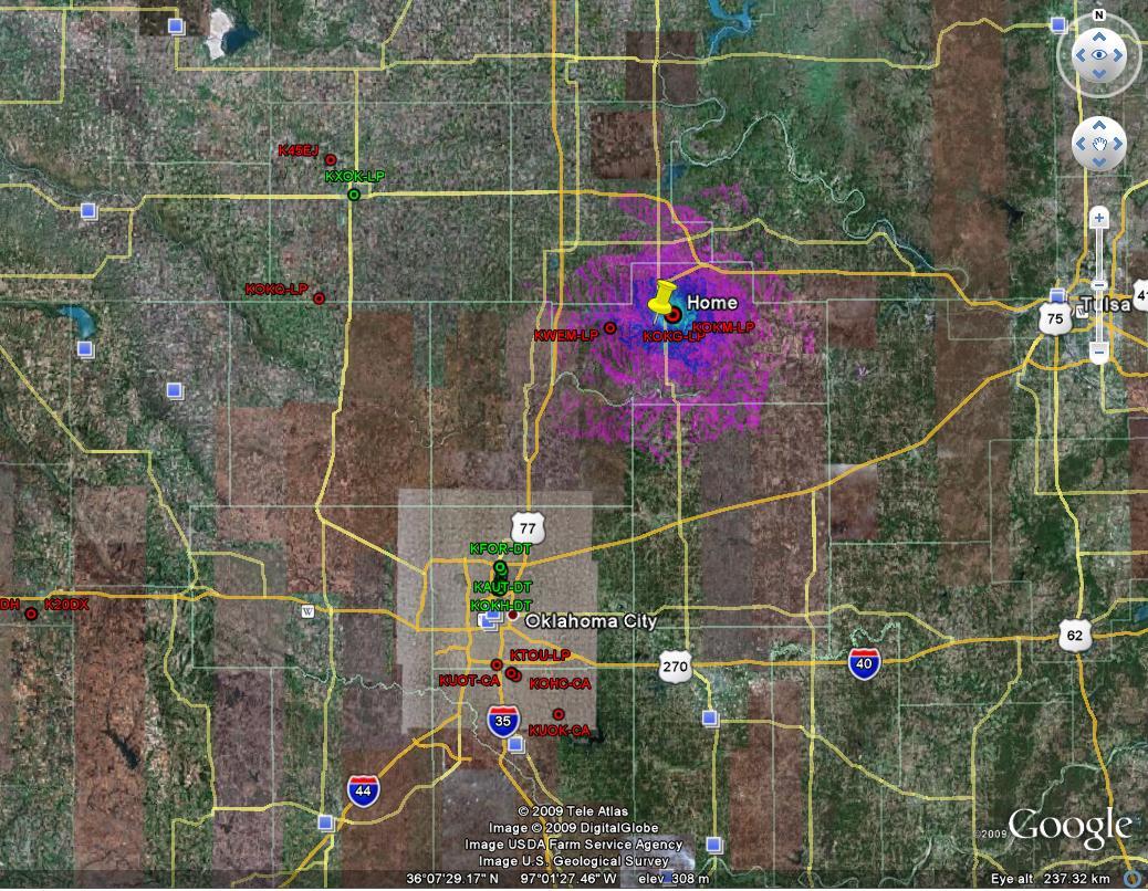

I am in Stillwater, to the NE of the KOCO tower so this shouldn't be the issue should it? From here, all the major OKC towers are between 206-208 degrees west. I got the antenna pointing as close as I could to 207 degrees using a compass and still no luck, although it did help the other channels signal strength.
Here is a coverage map of the KOCO tower according to tvfool.com. This came from an overlay available at that website that uses google earth. the KOKM tower next to the 'Home' pin is the one that shows up as a 'co-channel warning' with the KOCO tower.
:EDIT:
The KOCO name doesn't show up b/c it is hidden underneath the other tower names around it. I also added the broadcast radius for the 'co-channel warning' tower (KOKM) here in Stillwater.
:END EDIT:

Please post your tvfool report.
Which report exactly? If you want the TV Signal Analysis, I posted the results for my location above. As for the coverage maps in my area those are above as well. If you mean something else, let me know and I'll post it.
Oops, I see it now, sorry.
