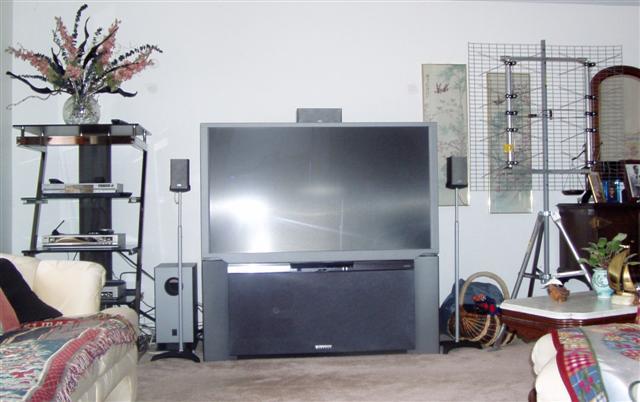

cm4228 outside...or cm4228 inside after a few days the wife will say ..."get that big friggin thing outa here and put it outside."
The cm4228 will receive ch 10 and 13.
had nothing better to do...for a laugh check out the picture. Had a cm4228 in stock

Attic install is a good suggestion. Cm4228 in the attic with a hdp 269 amp to counteract the losses associated with inside install. you will need the cm 4228 to receive ch 10 and 13. The other uhf onlys will not work.
