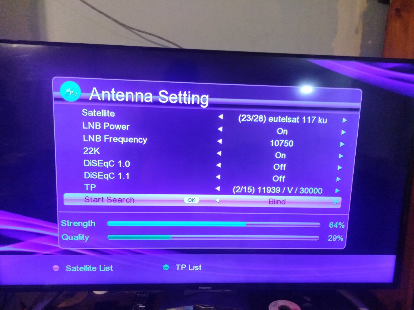

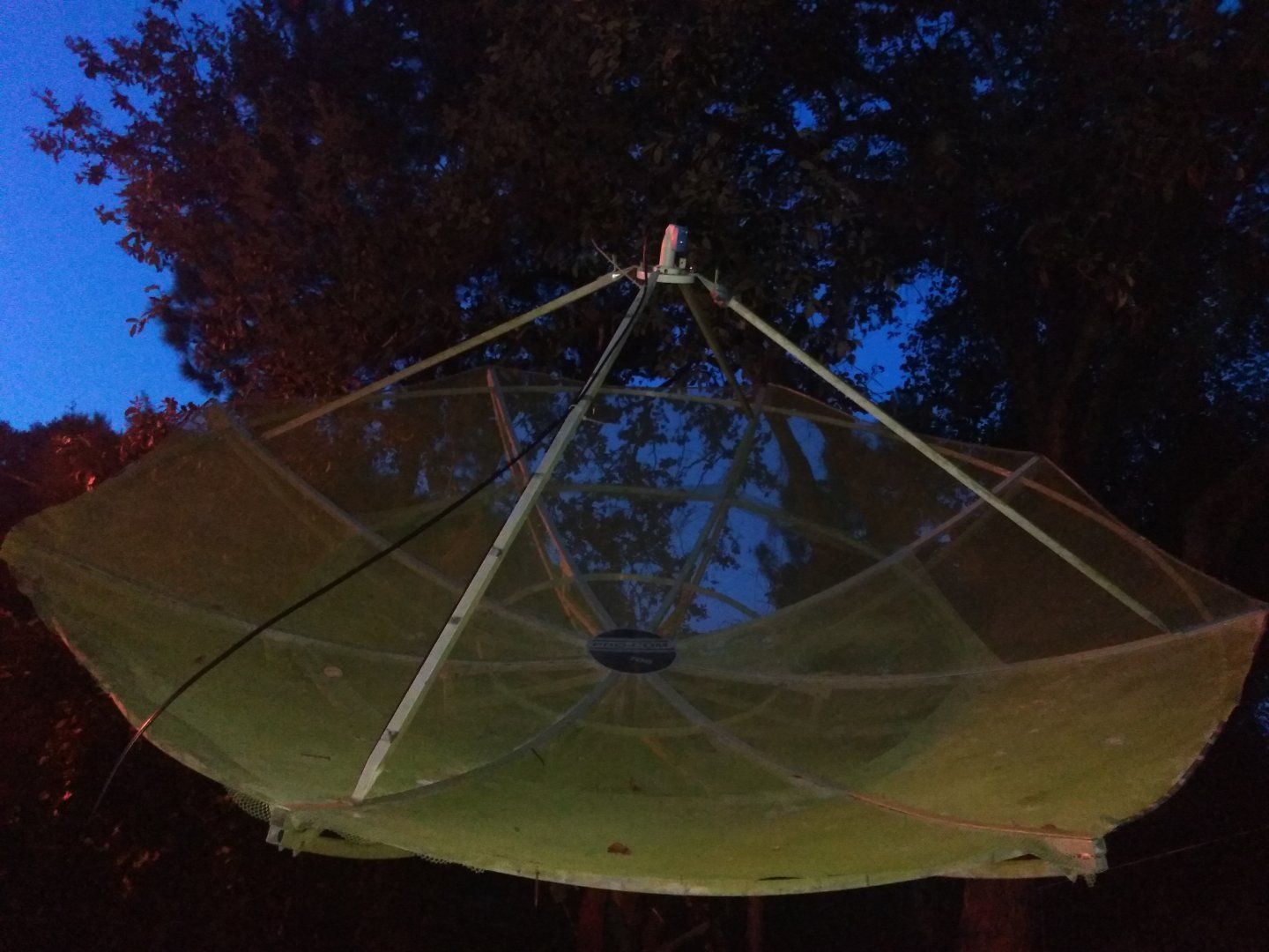

OK so I ordered a new lnb. So I could try it on my 2nd 10 foot satellite dishes.

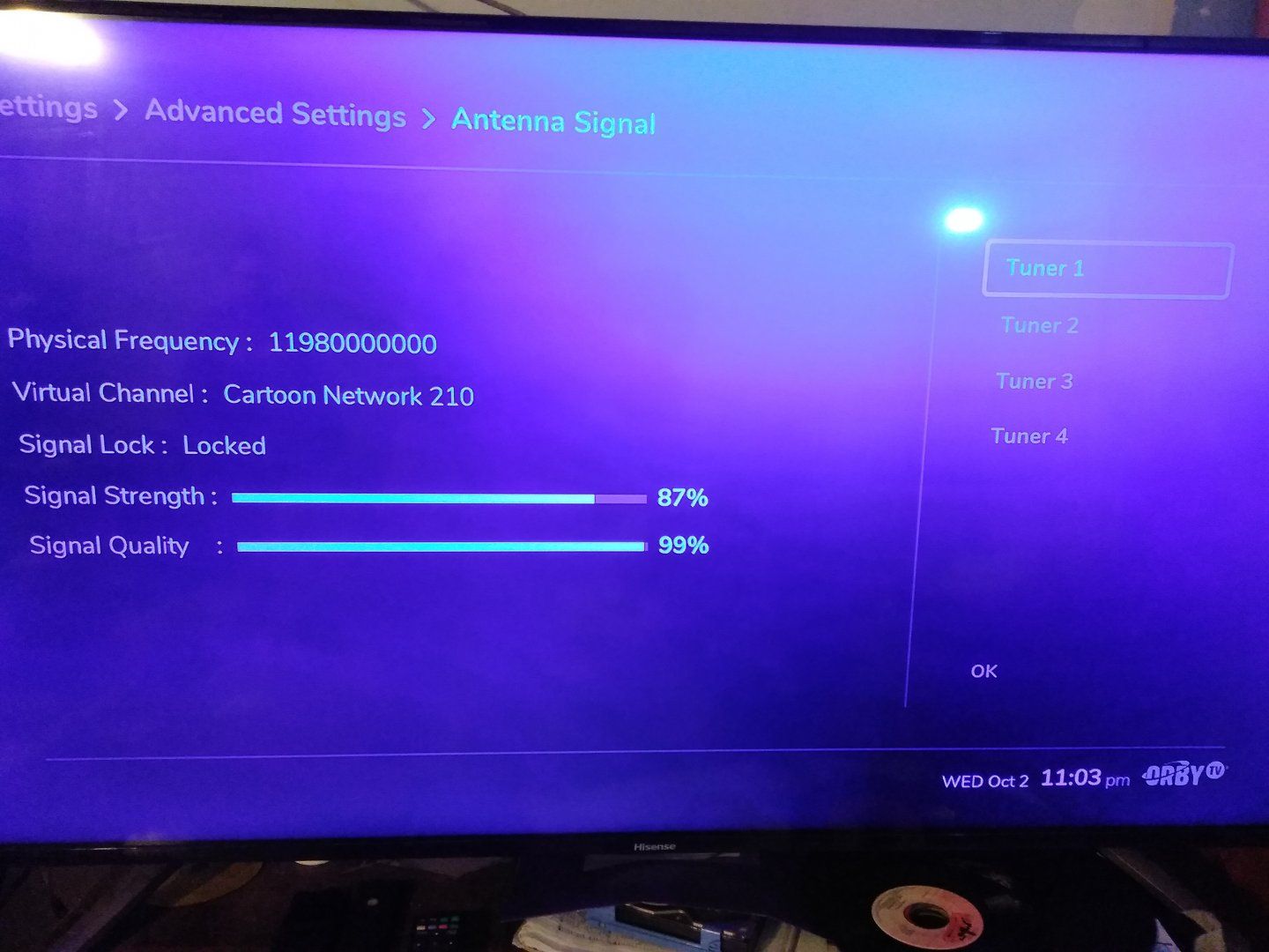

It's working good. So I hooked the dual ku lnb so I could use it with my fta system.
I hooked it up on the 22k 13/18. And Orby works which makes me happy. Since it works in any room and I have my main box in the family room. Set to control both control boxes.
My c band control box is 1 to 16
The 2nd box is 17 and up...
Notice the fta box does not read the same quality as the Orby. My other fta box reads correctly.

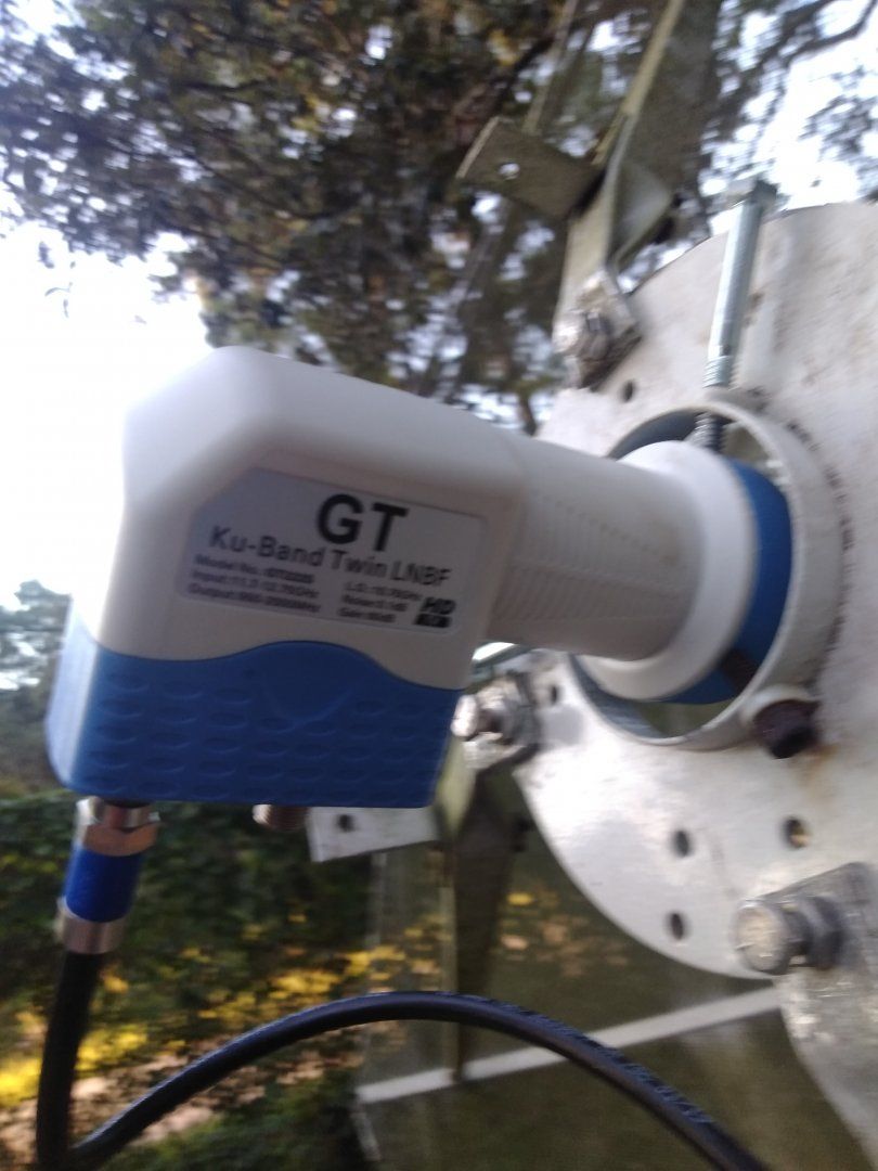

The LNBF in the photo is designed for .5/.6 FD offset reflectors, so it is only seeing (illuminating) a portion of the reflector surface.
If you want higher gain, use a prime focus LNBF, which is designed for illuminating a .3/.4 FD reflector. Then it will see the entire reflector surface. Geosatpro sells the SL1P model.
For even better KU performance on your BUD, use an Invacom C120 feedhorn and an Inverto Black Pro flange LNB.
The shared C and KU through the multi-switch will be more compatible with FTA and Orby STBs if C-band is placed on the 22KHz 13/18 and the KU-band on the 0KHz 13/18. Orby does not output a 22KHz tone, so the switch could return to the typical 22KHz OFF default.

Now that fta receiver. Only reads about half the power of my other one.
I think the blue box maxes out somewhere in the 50% and that's 100% on my orange box..
But I do have some tree branches right in the path of 117w.
103w I get close to 100% on the Japan TV station.

I'm not sure why they have the 22k on.
I can tell you it works good. Somehow my movie channels were not coming in. They resent the hit. And the box received it.
So that proves. With the upgrade. Orby will work.
