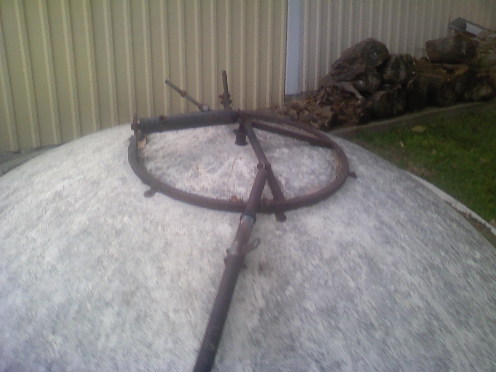

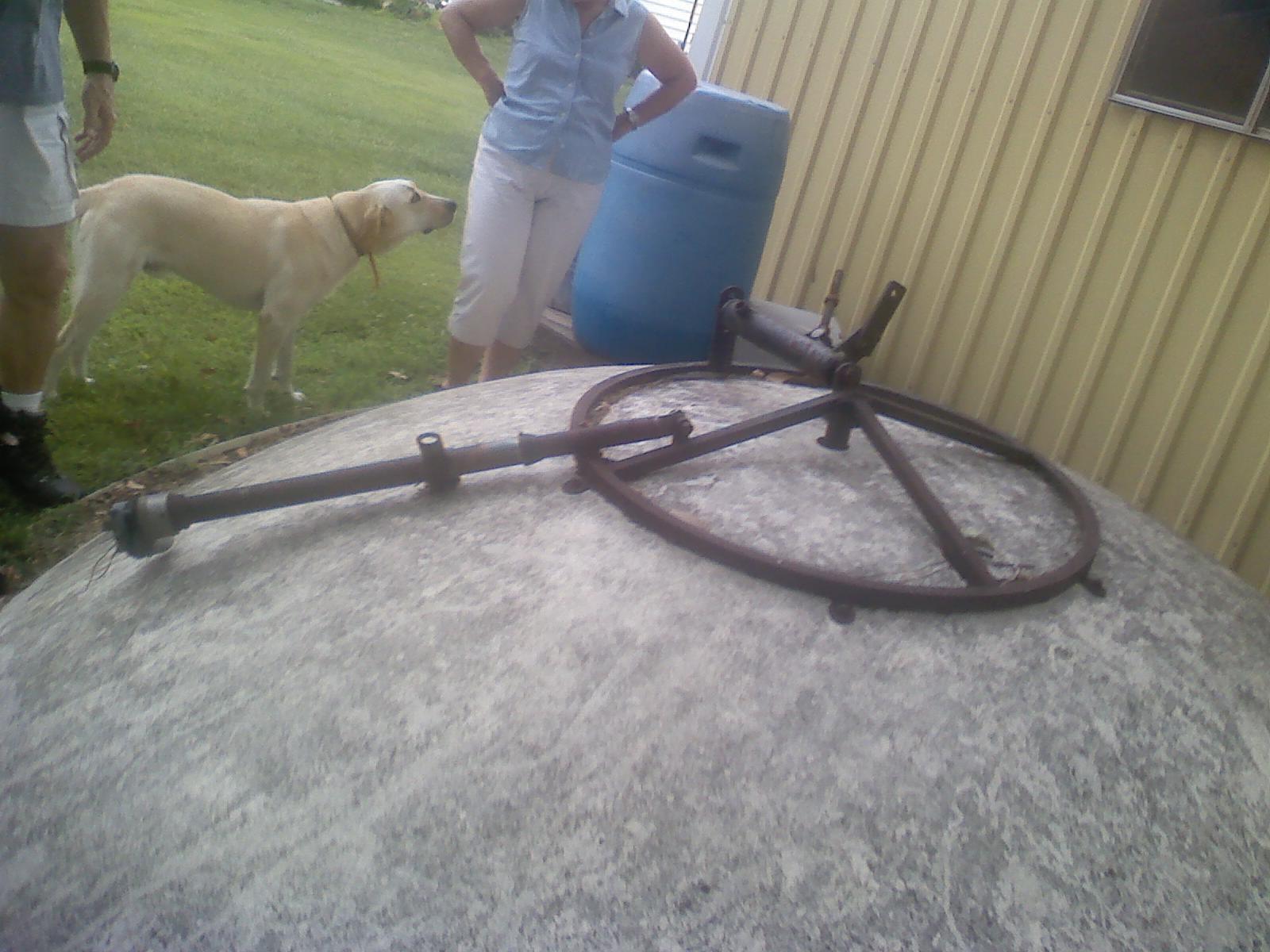

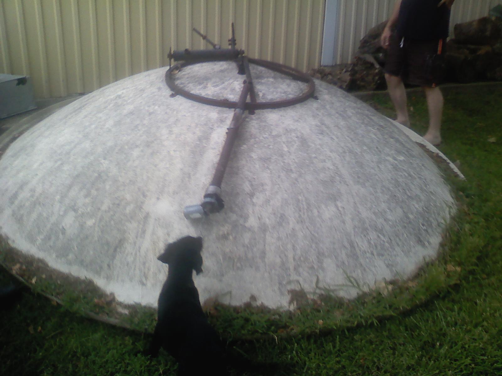

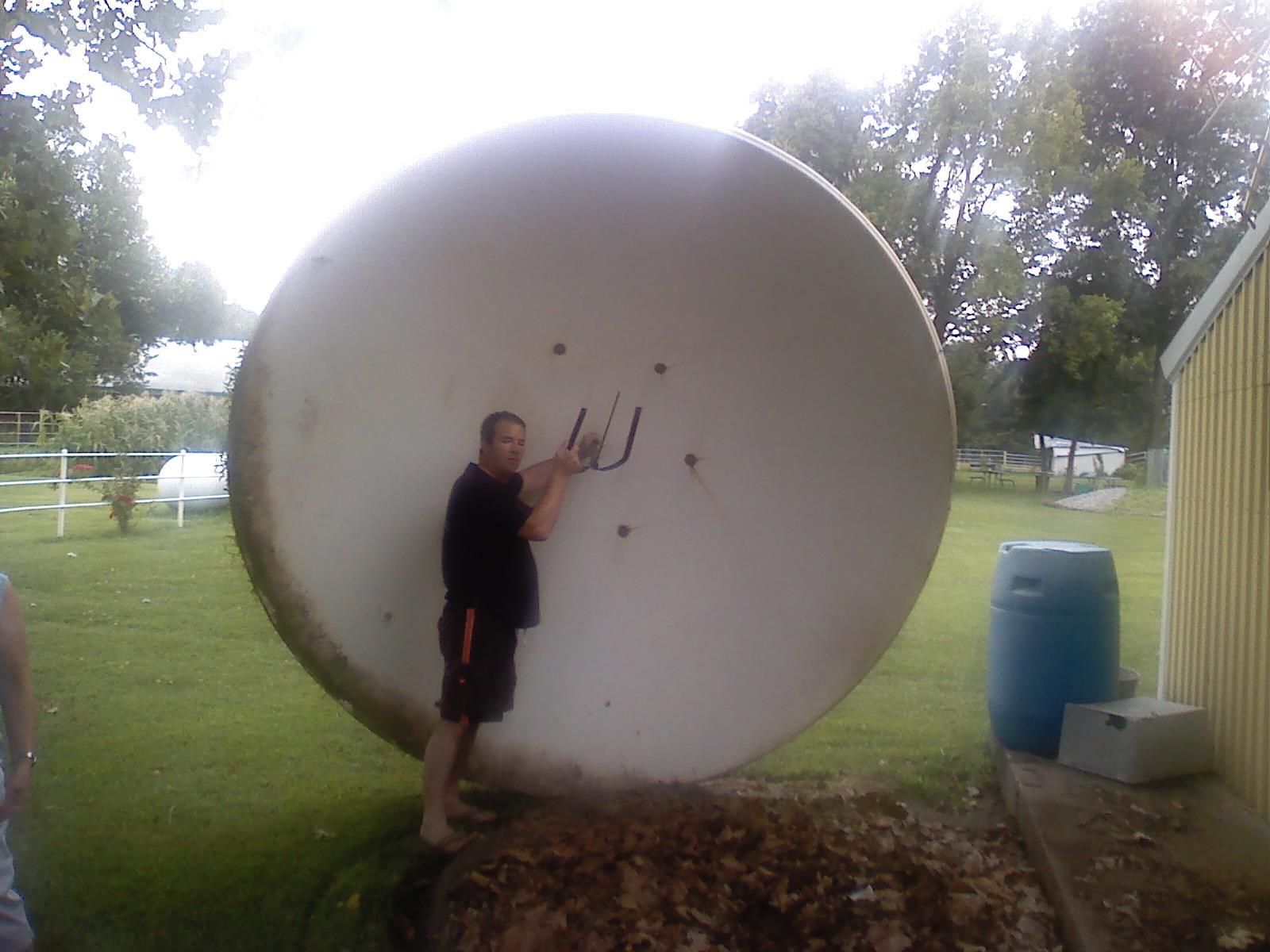

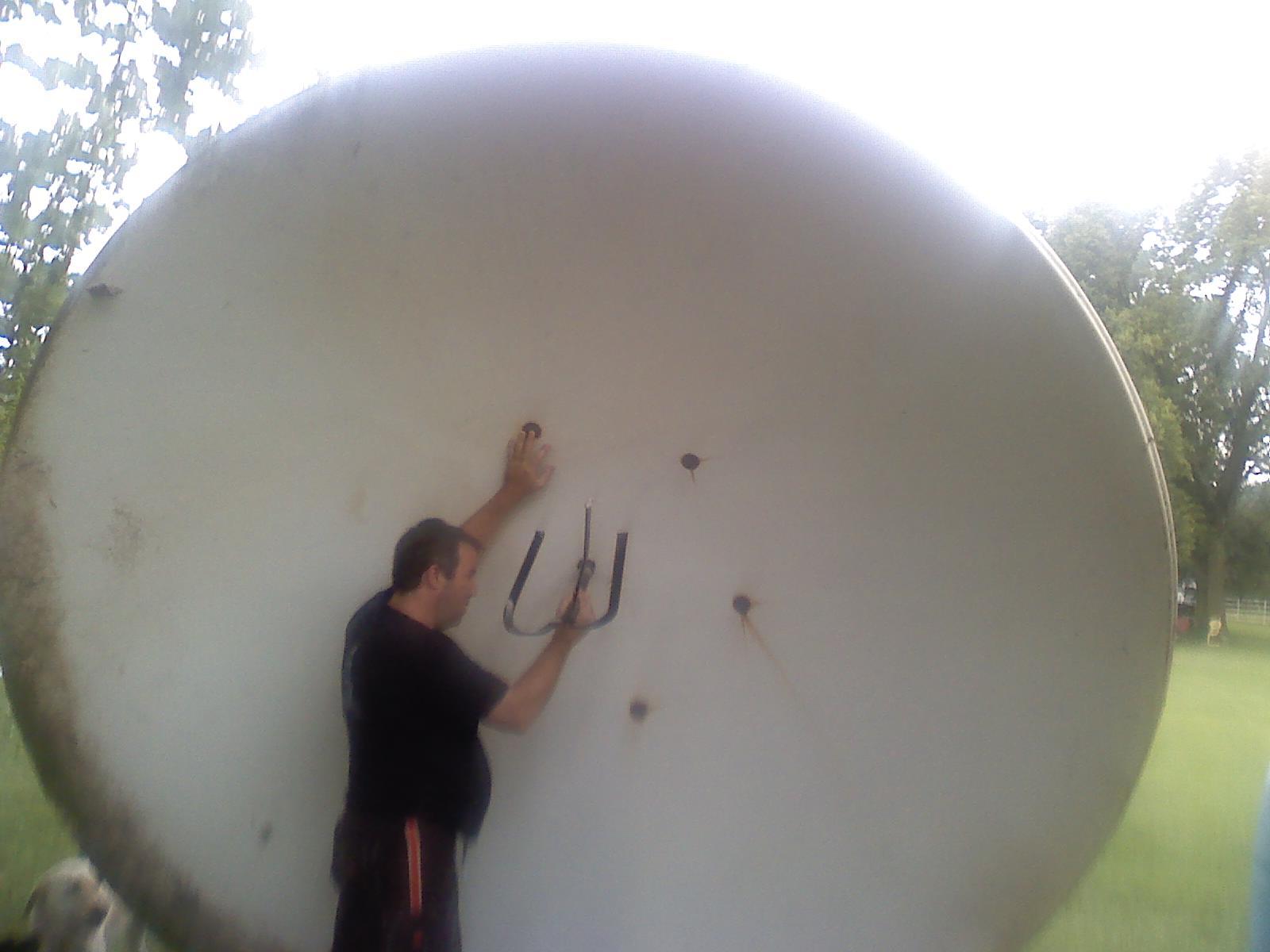

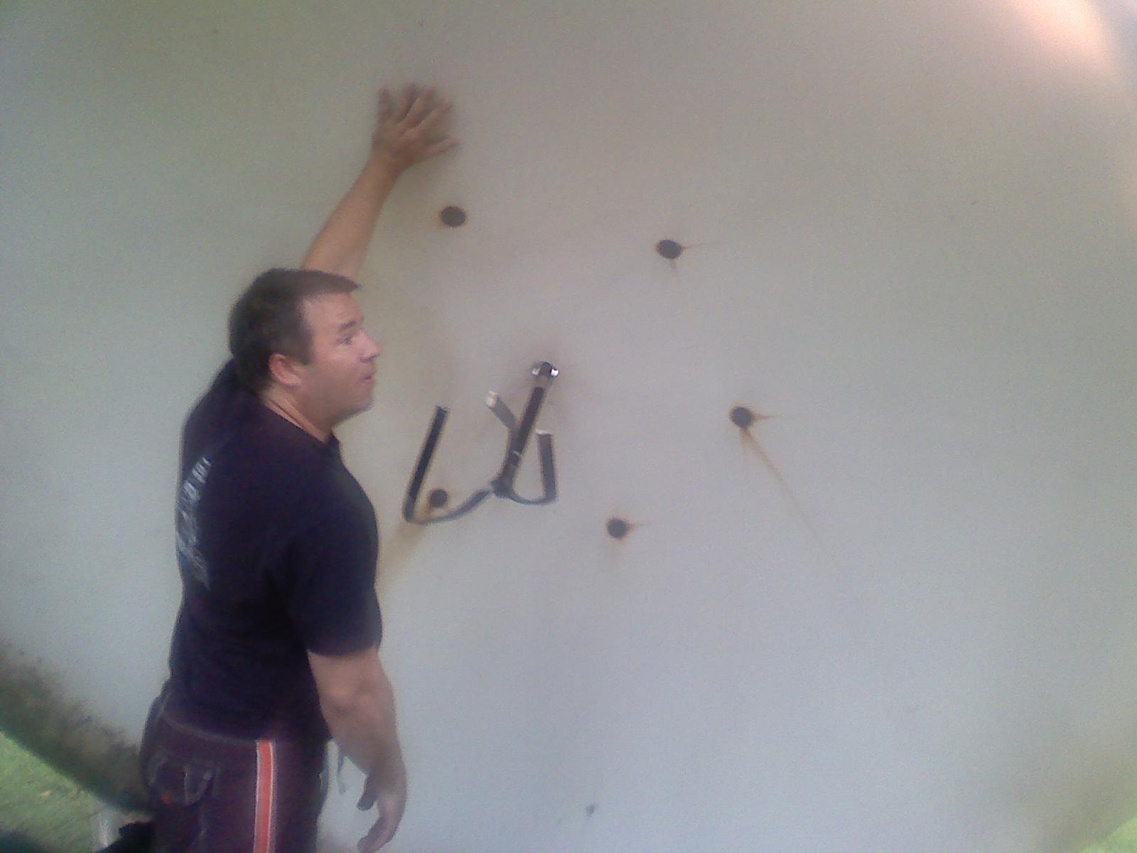

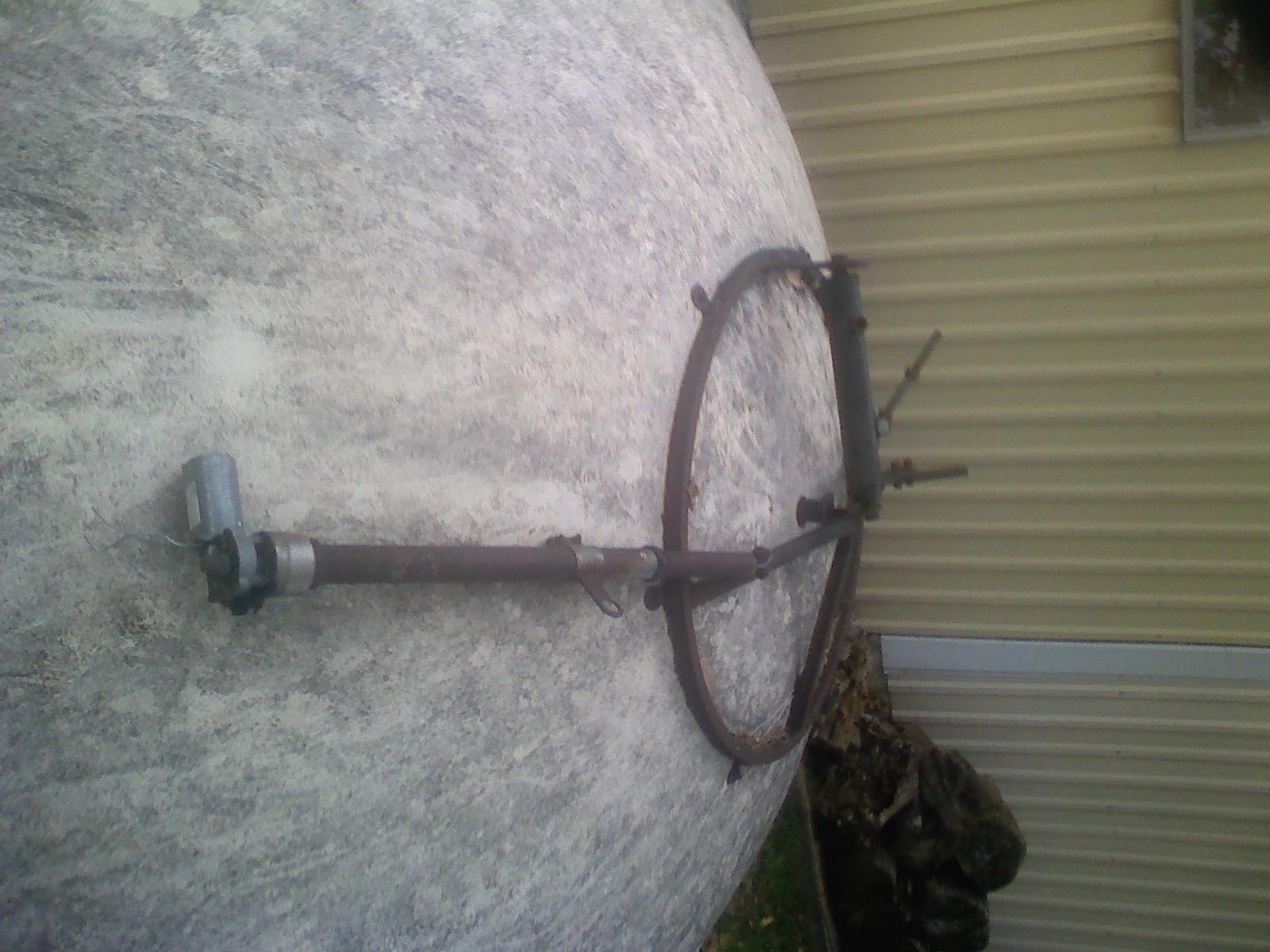

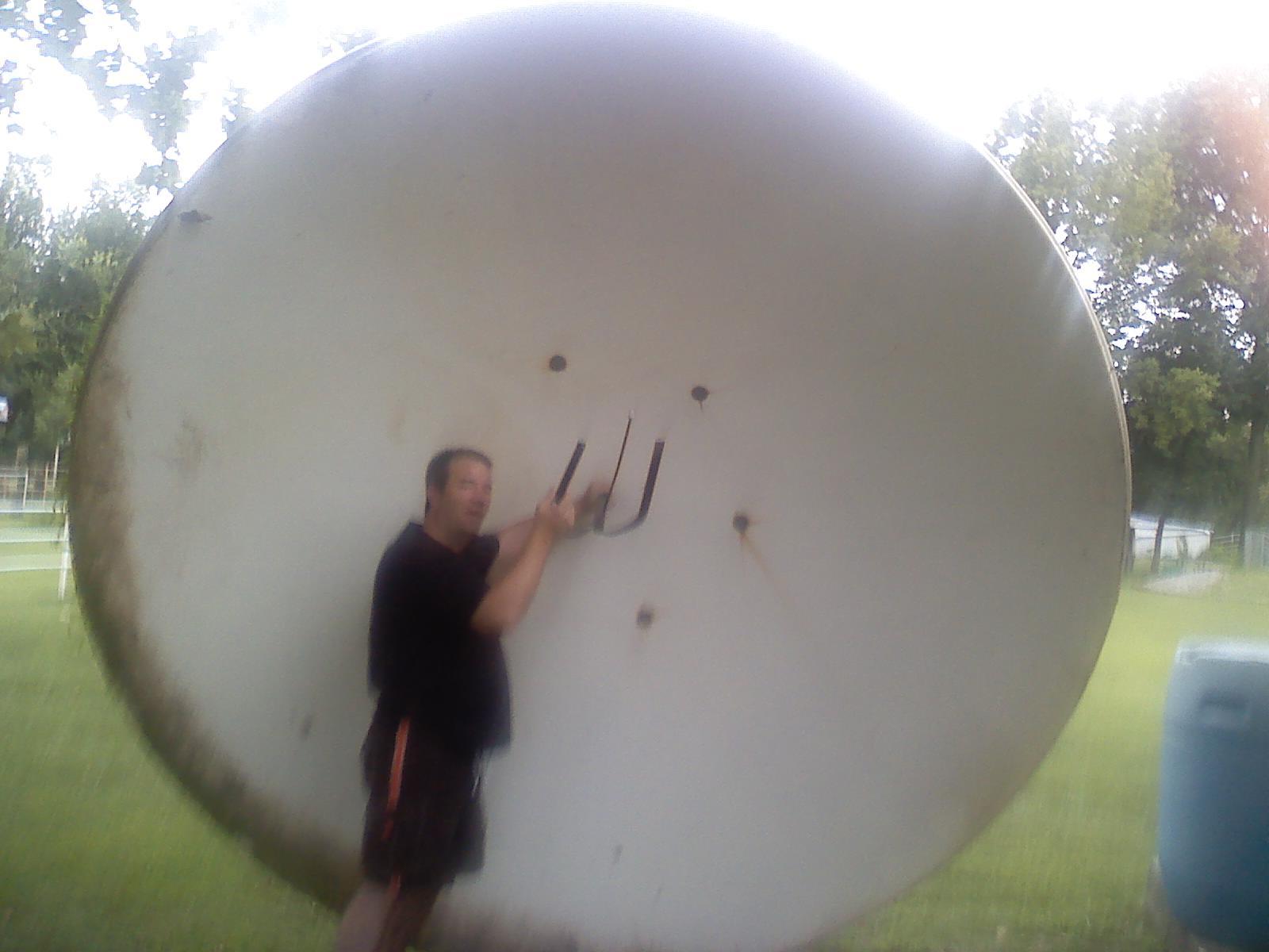

as requested here are some photos, i also have the polar mount and lnb

If I were you I'd keep looking.... I think that dish will be nothing less than a big pain in the neck for you to install. That dish has to be really heavy.
Besides the weight factor it's highly likely that it was laying on an area that probably wasn't level (the ground has irregularities) and this will cause the dish to warp. And since it's a one piece there isn't much you can do to change that. One piece glass dishes were notorious for warping.
Are there any pieces to mount a scalar ring / feed horn on?
If not. I'd pass. You ought to be able to find a dish with all the parts.

I'm wondering if the dish originally had a button-hook LNB mount?
That's where there's a pole sticking pretty much out the middle of the dish, holding the LNB and scalar.
You obviously lifted it up onto its edge.
Can you estimate the weight?
Could you and one other adult take it to your truck?
I'm thinking it might require three or four to carry it.
Depending on the dish weight, your ability to transport such a beast, and what sort of yard you have... here's where I'd go next:
I'd flip it over on it's back, and run three strings across the dish, about 60° apart.
Tape 'em down at the edge.
See how closely they all meet in the middle.
Also, you need to be willing to bury a pretty stout pipe into some concrete.
And, you need to understand that if it isn't all it could be, you may some day need to replace the dish.
On the up-side, I'm guessing it'll do C-band better than a 6' dish!
Even if it performs no better than a 7' dish, you'll have something new! - :up
I believe I'd pass on it. From what you've shown, it'd be a big first-project. - :rolleyes:
Yes it has a aluminum plate (severely bent) that the scalar mounts to. I have the lnb/scaler with the plate. it does have the "button hook" type mount i guess. there is a single pole coming out of the center to hold the lnb that branches out in three directions.....kinda like a pyramid. You can see the mangled remnants in the pictures. It has a tube with set screw that actually holds this mount allowing it to be adjustable in terms of distance of the lnb from the face of the dish. I thought this might make it easier to refabricate the lnb mount as you could just mount it up and tune it with the adjustment. The dish actually didnt seem that heavy to me. I think 2 stout guys could load it up but three would be safer as its sheer size makes it awkward.
Thanks Anole and everyone else for the help. I am still undecided but have time to decide as i don't think its going anywhere. The comment Anole made about it Probably being better than a 6 foot dish was helpful. That was one of my concerns as I realized that there probably is some warpage. If there's no gain over a 6 ft dish I might as well Buy the system that sadoun put together here C-Band Satellite System
rather than spend a comparable amount setting a 5+ inch pole(still need to measure the polar mount but as I recall it was huge) and probably buying a new lnb and actuator.

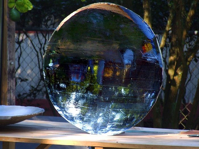

Or you can just convert it into a SOLAR WATER HEATER project and track the sun with it. You will for sure get enough hot water for your house and neighbors including a swimming pool. :up
