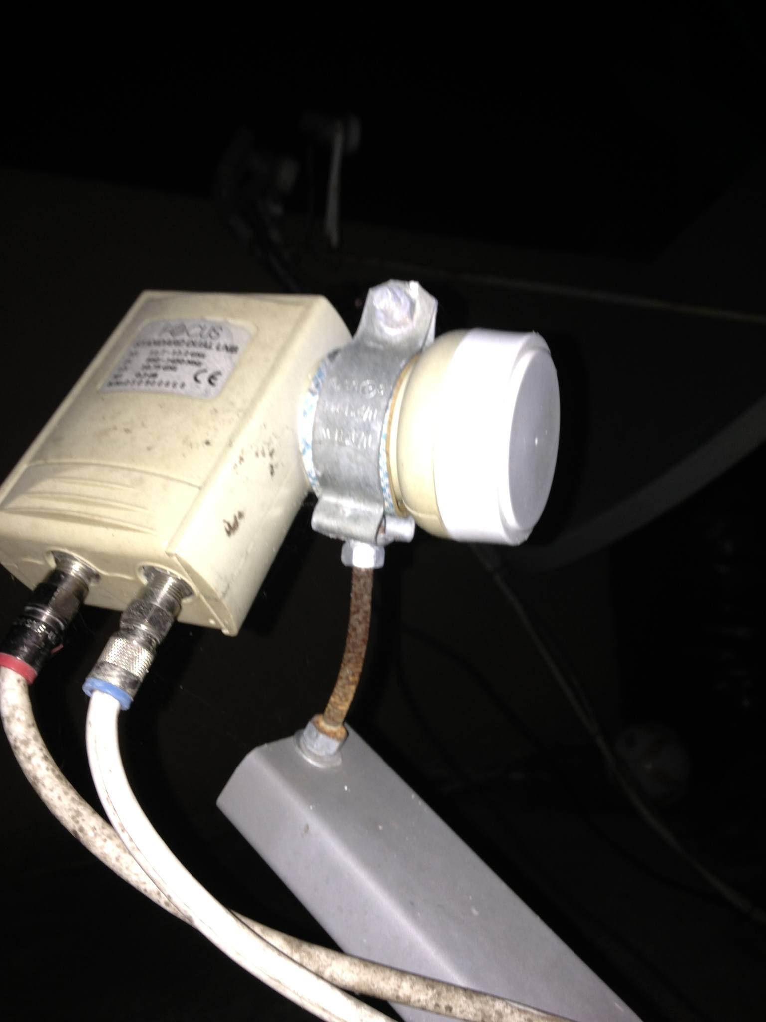

- I'd use conduit hanger brackets; about 65-cents @ Home Depot

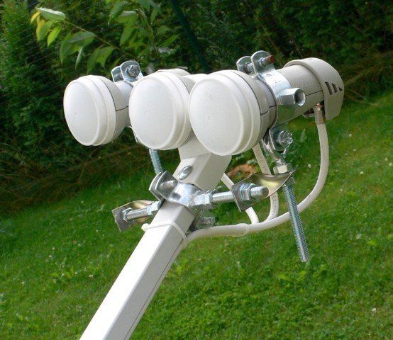

That is not so difficult to make something like this. Easy to attach to round pipe. Costs almost nothing. Perhaps you even have all needed parts in your garage.
