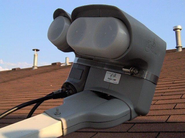

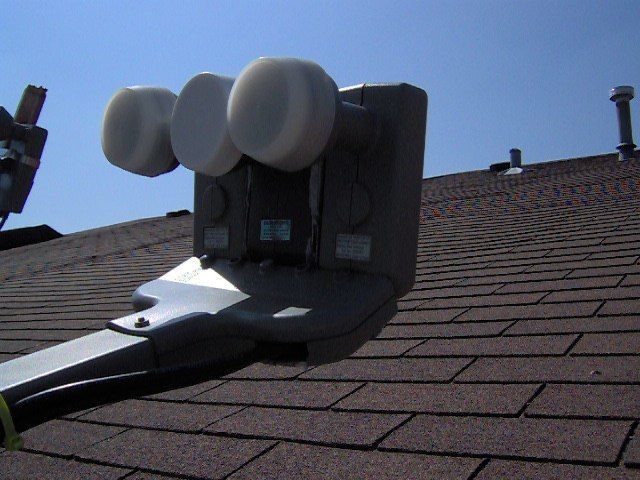

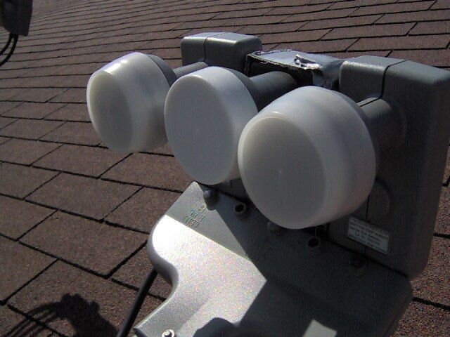

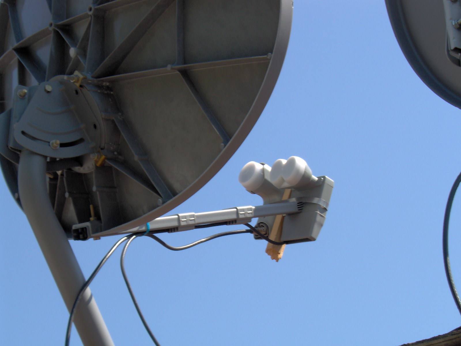

I've found that you can use a Dish500 (poor man's Dish1000) to pickup 110, 119, 129 the easiest way by placing a twin lnbf's 119 side on the 110 slot of the yoke leaving the 110 sticking out not on the yoke and having 129 on the 119 yoke slot. I've gotten over 100 on 119 and around 80 on 110 and 129 without adjusting the skew but I imagine that the skew needs changed for optimal performance. I have seen posts in the past where someone strapped an lnbf to the twin on a Dish500 to pick up additional satellites. I imagine someone could strap an lnbf to both sides of the twin to pickup Directv 101 on one side and 129 on the other side. How would one figure out what the skew is for adding one lnbf to one side or adding an lnbf to both sides?

Here are a few subscription satellite options that I have done

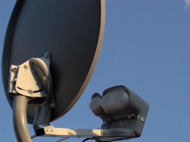

1st is adding a LNB for 119 to a Starchoice dish aimed at 107.3/111.1 This allowed me to use a separate 24" dish for 110. Buried the needle on most TP's on 119
2nd & 3rd is adding a LNB to a Dish 500 for 129. Got 75-80 on Tp's (this is when 129 first was moved there before they threw stuff on it)

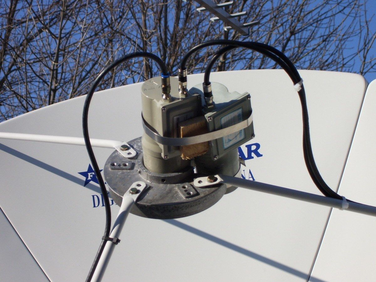

5th is adding a DBS LNB to a motorized FTA setup

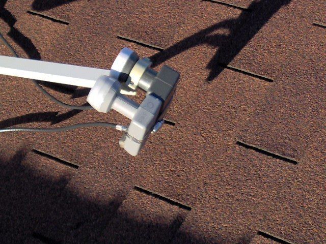

6th & 7th I took a Phase II and put a LNB on 110 for subscription (119 was on the SC dish) and added a KU in the middle for 101 (AMC4) and a DBS for 91 (when the audio was free on ExpressVu)

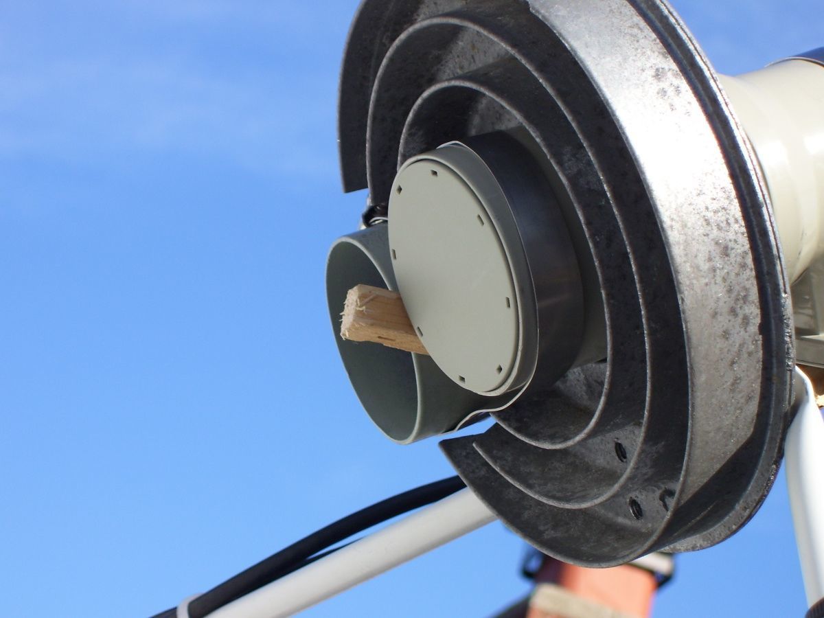

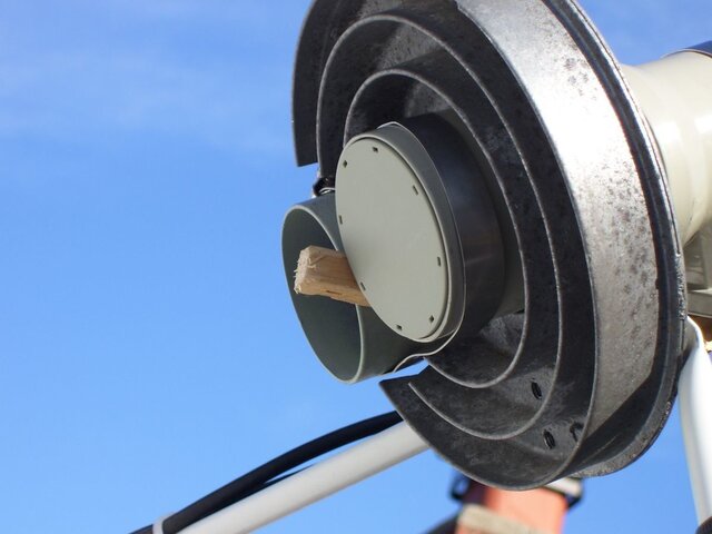

last one is when I chopped off some of the scaler ring off the C-Band dish and added a 2nd LNB to get both 99 & 103 C-Band. 103 is low signal but it works and C-Band has very little rain fade :)

I made a dish 500+ with SD105, took 118/119 assy and put on SD 105 only mod was a drill a hole for mount on arm. Re point dish and it works very good
