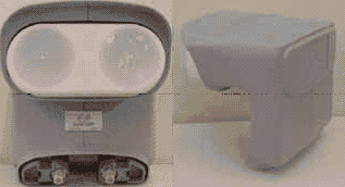

Press Menu twice in the remote and tell us the exact equipment you have. Example, DPP Twin, DP Dual, etc. Some people call the lnbs dual but sometimes they're actually Twin Lnbs.
Sounds like a bad LNB that's overheating. If you can reach the dish, pour some water on the lnb to see if you get your signal back. If the signal comes back, you'll need to replace the lnb or have Dish Network replace it.
The first picture is a DP Dual, the second one is a Twin.
Randall;
Thanks for the reply and good info. Sounds like you may have it. The picture that you sent helps, we have the twin LNB. When it goes out I will try what you said with the water.
We do not have a contract with dish at present and all the equipment is paid for, so I will have to replace it myself (no problem).
Thanks again for the help.
Danny
I would just replace the lnb with a DP Twin and save your time troubleshooting. You could try what I suggested just to confirm. Just pour enough water to cool off the lnb and make sure water doesn't go inside the connections. :)
