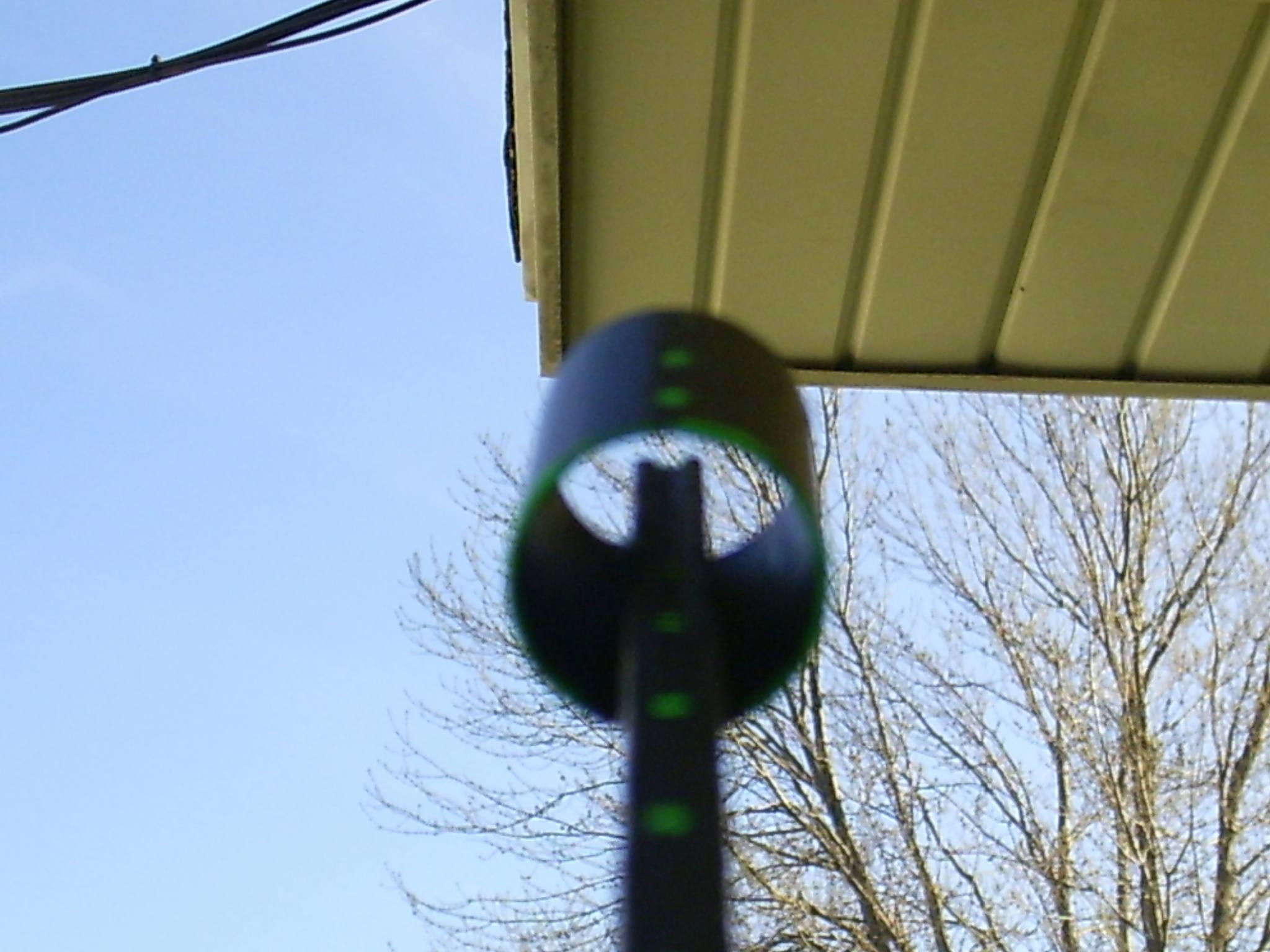

Very nice, before I got my site survey meter I used the below device, I had one made for all the key satellites.
