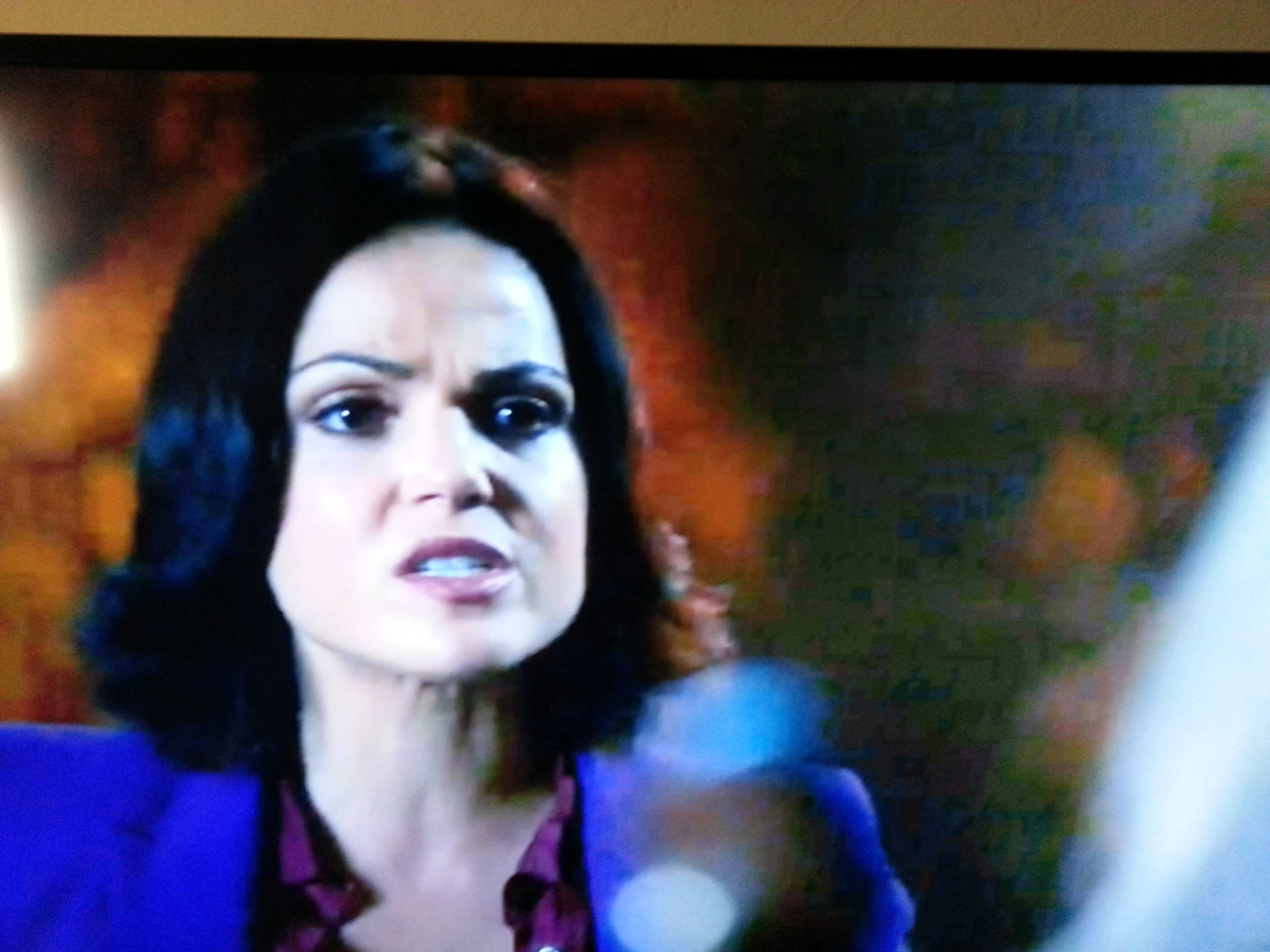

Check out this pic:
See those blocks? Those are noticeable when playing the show. It's worse when paused, like in the picture.
A technician actually just came out. I showed him how much better things look when playing off the USB vs what is on my DVR. He said his own TV does the same thing and thought it was normal!!! Two managers are coming out tomorrow...

Although posting a pic is not always representative, I will say that does not look like HD.
