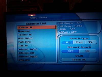

Just got my Ultrasat yesterday (Yay) anyways here's what I got.

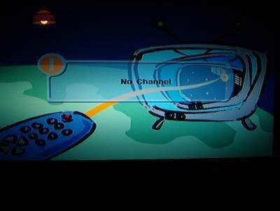

:confused: I believe i have everyting wired correctly, I just can't seem to get it to work. I have the sat mounted on a fence pole in a bucket of cement and checked to see that it is level. I used a compass to point the sat south. I try to set up autoscan and nothing happens I just get a "No Channel" Screen. :confused:In the auto scan screen it says my LNB power is on so I guess that's working. :)
My zip is 78418 if that helps.
Thanks in advanced, :)
Ben

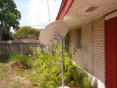

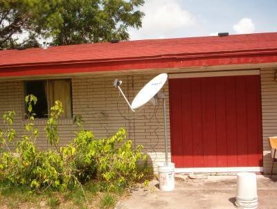

holy crap, thats one hell of an inclination... that looks like its pointing straight up?
Sorry, it was lower before. I was trying to elevated it to see if there would be any improvement.
Your dish elevation should be about 40 degrees (40.4 according to the calculator) for a Stab HH90
lnb freqs is wrong
You're lnb freqs should be 10750 not 11250 I notice that in you're screen setup in you;re pic
Yes I see that too, but I can't navigate into the box to change it. Is there another way to do this?

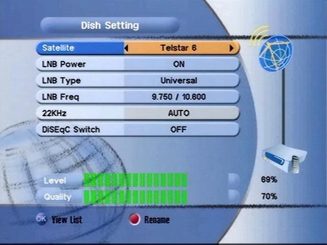

From the main menu go to "Dish Settings". That will take you to the screen I have attached. You can change your LNB type and/or frequency from here.
Cool, I will do that tomorrow. Thanks :) :yes
