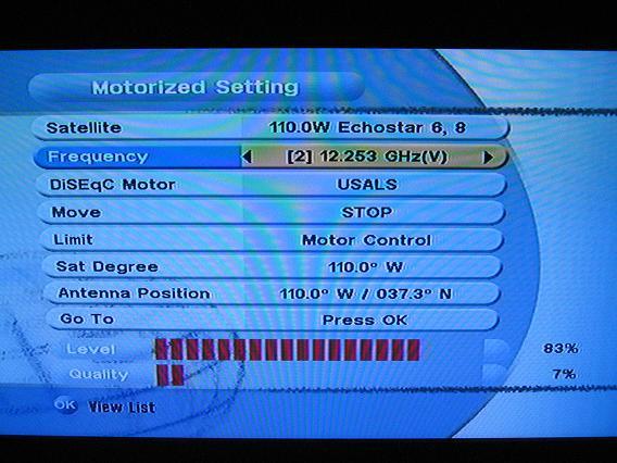

Hey guys, everything went fine until I wasn't able to get 110. I can get 121 (my true south) and I can 148, but I can't seem to get 110 or 119. What am I doing wrong?

Did you set up the LNB for 110 and 119 to use a LO of 11250?
