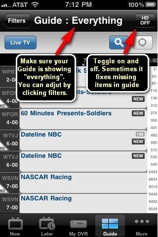

Another little trick I found is to toggle the HD only option.. It is in the top right hand column..
I never had the guide come up completely blank but have from time to time had certain channels missing.. The above trick usually fixed the problem.
Also make sure you guide says "Everything" at the very top.
Kevin.
