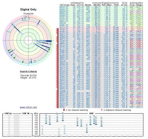

I live in Flatwoods,Ky. and have tried an antenna to receive my locals in HD. But I am not able to pick up anything.
Not sure why not; maybe the wrong antenna for your specific needs or maybe aimed at the wrong heading or maybe a simple setup issue, but from your zip code your affiliates should be fairly easy to tune with the correct equipment and setup. (see chart)

Put in his zip, chose digital stations only, looks like red zone antenna for all but PBS. I'm not aware of any "indoor" antenna that would work for this. Take a Channel Master 4224, put it in a closet, as long as it is aimed properly, I believe it should work for all but CW, which is at 319 degrees until Feb 17, when it moves to 98 degrees.

Who said indoor? I said correct antenna. I think most user think they can just attach anything in any manner; they don't know they need the correct antenna that is also aimed correctly.

Sorry, did not mean it as a slight to your post, just seems like many are only willing/able to try indoor, and fully agree with your "most users think..." comment. Correct many times means outdoor.
