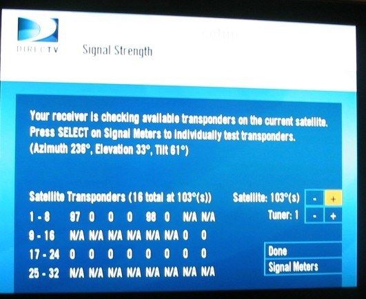

I go to setup and signal strength and here is a picure of my screen.
This is my actual screen.
But I am stuck on satellite 101 I know I need to arrow up into the plus or minus but it wont go there. What am I doing wrong. I can change transponders and strength runs in the 90's on most of them. three of them have zero's and one is 54.

you need to go into the receiver and do the sat setup. IN the maze of menus
Menu
setup/favorites
setup
satellite
rerun satellite setup
or something like that ;)

99(s) 0
99(c) 68
103(cb) 0
103 (ca) 0
103 (s) 0
119 0
110 0
101 94
So all 8 need to be 70 or better? what about transponders, so I need to croll thru them also?
Ok they all look good except for 99 (s) and 103 (s) those are at zero. I flip to the tv and I am picking up all the HD channels. I guess I dont need those two?
(s) means spotbeam which you will see mainly 0's except for the spotbeam for the locals in your area (whatever they may be)
are the signals on 99 c and 103ca & 103cb good (above 90)?
