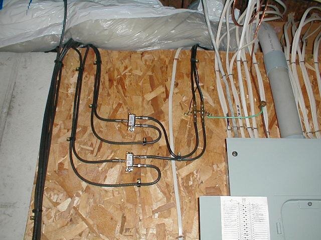

Just thought some might like to see a nice picture of a ground block, and diplexor setup for a 625 & 322. I thought it looked nice.

improper install job, theres no service loops at the ground block, the ground block is vertical instead of horizontal, theres no service loops to the dips either, but atleast the system is grounded correctly.
Van
The install is indoors, why would you need drip loops? There is probably a foot of extra cable in the rafters if you ever had a fitting go bad. As there would not be any water inside there should not be fittings going bad.
Service loops, drip loops, still its required by my company and even though its in a basement it has little bearing on it, no ones ever seen a water pipe burst in a basement? And if its not being done inside then who's to say its not being done on the outside.
Yes I have but arn't we getting a bit extream on what should be protected against. In five years how many systems have you had to do a service call on because a pipe burst in the basement and caused the connections on the ground block to go bad?
I'm inclined to agree that the service loops are a bit extreme on the inside. Not to mention that if there's a water pipe break, wouldn't it ALSO get into the circuit breaker box and short all of the household electric out? ;)

Isn't it code that the grounding block should be done outside?
not in my area. I think that is a local codes issue.
As for drip/service loops in relation to a pipe leaking and spraying on that setup, you would have to say that all that romex coming in to the service panel should have loops too, otherwise anything spraying over there is gonna have a straight run right into the box.
Van, I see your concern on what the quaility of work is on the inside might be reflected outside, but I wouldn't assume anything since we can't actually see what is done outside. I also think the work inside is fine, but generally the practices I have seen are to do the inside setups like they were outdoors so loops etc are all done no matter where they are.
I stand by my convictions, do the loops on the inside as you would on the outside for good measure, it doesnt take anymore time than 5 seconds to make a loop, it also is an extra measure against water contamination should a water line pop or a sink, tub, or toilet over flow. If your not doing it on the inside then chances are you arent doing it on the outside where its more critical.
I agree with you Van, I stated that in my last paragraph that it is just good practice to do everything inside or out the same way. All I was saying was I won't assume anything on the outside unless I see it. I learned long ago, never to assume anything, so I am also not assuming the work outside is correct either.
But I do think the work inside is ok as is if it meets code. Not saying that the code isn't possibly lacking, but if it meets code, that is all that is required and we all know that is all many people will do.
Let me ad my .02 cents, according to the install guide the service loops are to prevent water from entering the premises, and not entering connecters.
Now if this is true, and a pipe breaks, the water is already in the premises so why the service loops?
