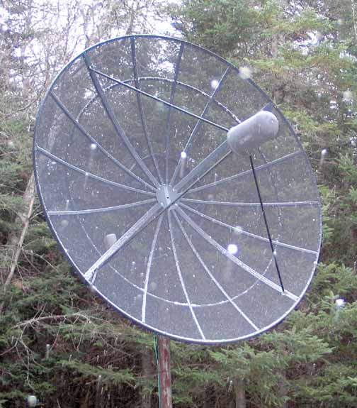

We tried it with the power on the receiver with no success. BTW, the dish is a UniMesh with a Chapparel lnb. I don't know enough about these things to know if perhaps one needs to replace the lnb with a universal digital one. Any thoughts? Boy, one learns lots very quickly on this site. Congratulations to those responsible, and thanks to those who so patiently assist us newbies. :)

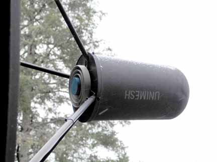

According to the docs, the DVB card expects a "digital universal LNB". I have no idea what the lnb is on the 10' dish - analog maybe? Is there an easy way to determine that?
More on C-Band dish
Here are photographs of the dish and the lnb. Yes, that's snow on the lnb. For what it's worth, the old receiver is a Panasonic 700 PSEX.

you need to take the feedhorn cover off to look at the LNB. my bet is it is a C-band only and with a very high degree rating.
