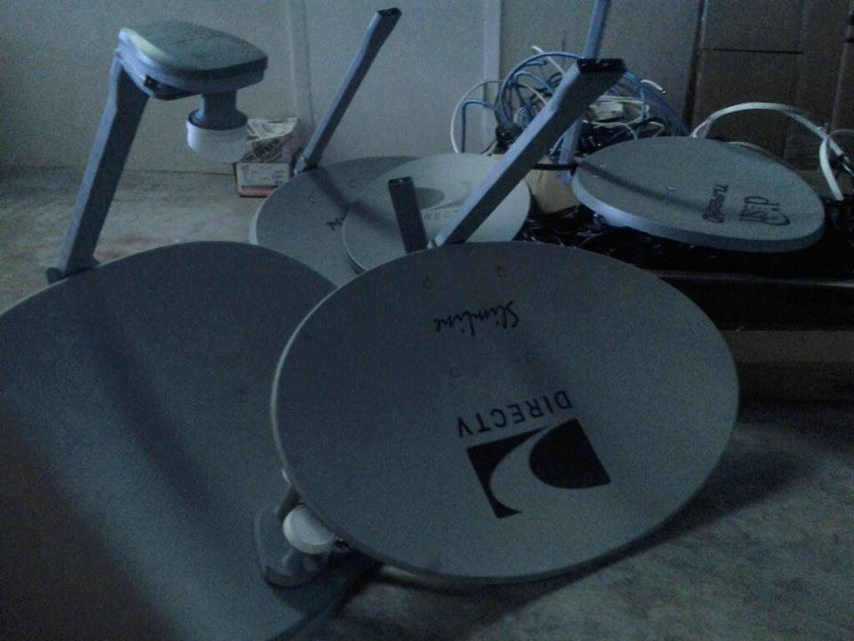

409155_10150587413188755_508398754_11146463_460778373_n.jpgAnything can be done with these dishes?
Pics too dark too tell much, but one of those bigger ones , the wide-oval types could fit the bill. All depends on the model/type of lnbf they have on them. Some of them have a linear lnb built-in, I believe.
View attachment 73694Anything can be done with these dishes?
I, and others have had some results using that DirecTv Slimline dish (front center of your pic). Check out the links in posts #3 & 4 of this thread for more info on using that one:
http://www.satelliteguys.us/fta-shack/276668-dish-hunting.html
I'm thinking the bigger dish on the far left of your pic might be the cream of the crop you have there.
Please post a pic or 3 of that one (front and back), and let us know the measurements (top-to-bottom & side-to-side) of the reflector.
Also post the info that is on the LNBF. I'm guessing that the LNBF that is on there is not what you want for FTA, but if it has the mounting style that I think it does I have just what you need to make an FTA dish out of it (or the Slimline), and would be glad to send you one.
