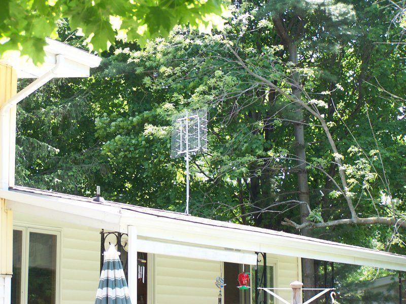

If I can post this... here's a pic of my antenna. you'll see what I'm shooting through...

Most articles discussing the 4228 state that it has a beam width much narrower than 90 degrees.
The size of that antenna makes it ideal for situations requiring high gain but it can be problematic in situations that require such a wide beam width.
Still in all i have seen both the 4228 and the smaller 4221 do things that the specs would suggest they either cannot so or should not do as well as they do.
FWIW here is ana d for the 4228 stating that the expected beam width is only 15 degrees. Amazon.com: Channel Master 4228 Long-range outdoor rooftop UHF antenna: Electronics
Yeah but that makes it sound like it doesn't do anything outside that 15 degree beam width. When in fact it appears that beam width is only taking into account the main lobe. The major null on the 4228 is at 30 degrees. That suggests a main lobe wider than 15 degrees.
But be that as it may..... you're correct when you say that antennas like this can... and often DO... do things that aren't in the spec. I can speak about how mine performs, but there are so many variables in this ... terrain... cables lengths... etc.... you just do the best you can. My wife thinkgs it's ugly... "look like part of a bird cage"... (I used to have 9 breeding pairs of amazon parrots).... then I showed her a really nice yagi and she said..... "ok, that one looks like you're going to shoot something down".
