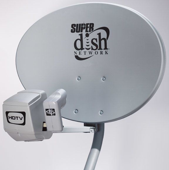

Let's not forget, the new 72 degrees slot requires a much larger dish -- about 20" x 35" as compared to 18" x 18". The larger dish is required because it's a FSS slot; FSS slots reside every two degrees (DBS uses nine degree spacing), so a larger elliptical dish is necessary to differentiate between them.
Some percentage of customers will not be willing to accept the upgrade to a 20" x 35" dish (which receives both satellite locations), even if it is free. They can't take away what these customers have now, so the core programming will have to remain at the current 61.5 slot for the small dish. New channels -- like HD RSNs, sports packages, and PPV -- make sense at the 72 degree slot which uses the larger dish. VOOM may use the new slot for some new SD channels (HGTV, FOOD, etc) until the MPEG-4 transition is complete. After every customer has the MPEG-4 module upgrade installed -- this may take a few months -- they can transition SD to MPEG-4 and move the new SD channels to the smaller dish.
