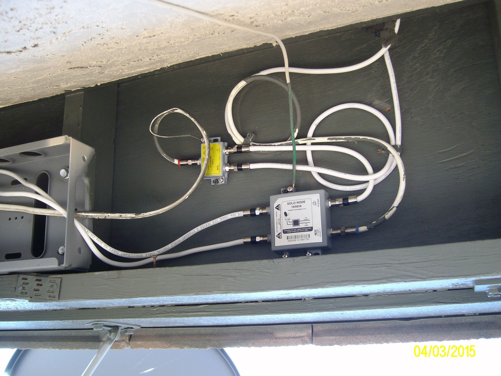

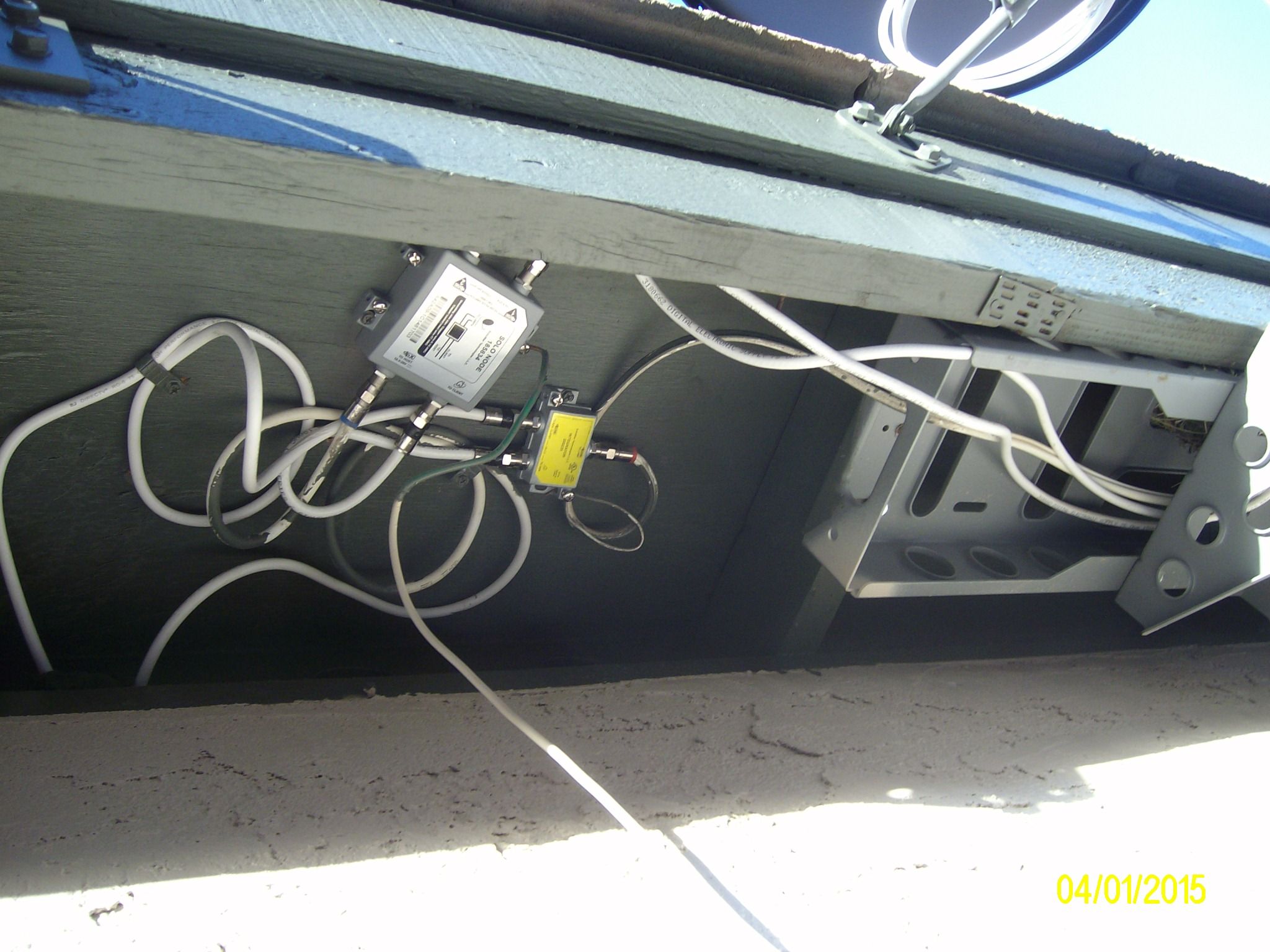

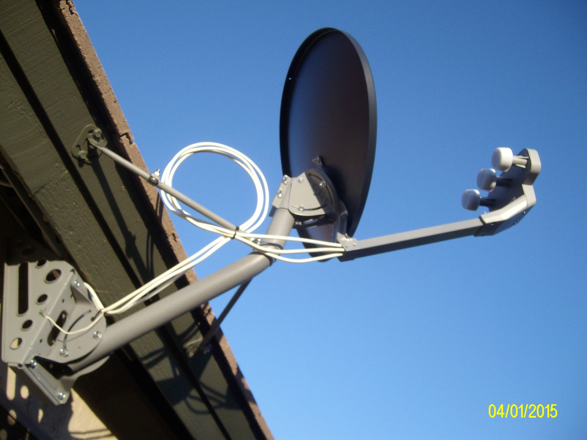

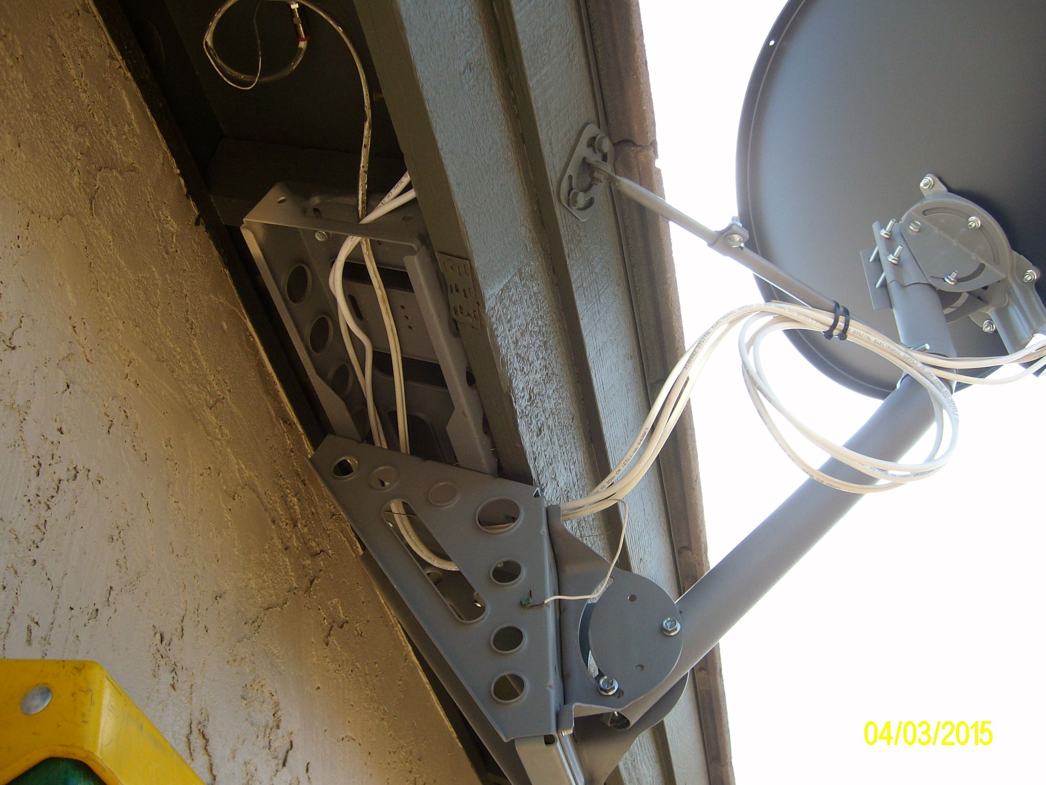

Yesterday I had a Hopper with a super Joey installed by a Dish Contractor (replacing my DirecTV). As you can see from the pictures, not a very pretty installation (btw, one story house).
The installer reused the original DirecTV coax cable from their dish to a grounding block (it is the coax that is partially painted). He reused also the DirecTV foot mount and the mast. To be fair, I did ask him to see if he can use the DirecTV eave mount because it is much better than any of the mounts that Dish is using in our area. However, I didn't expect him to reuse the mounting foot and the mast especially since the DirecTV mast is larger in diameter than the DISH. What he ended up doing is spreading the Dish mast clamp to fit over the DirecTV mast and using much longer screws to clamp it together. Everything else under the eave looks like it was thrown together by a kid. BTW, he didn't run new coax cables to the house, the original cables were perfect and it still took him 3 hours to do the install. Am I too critical of this installer?

Unless for some reason your under the eve mount could not be used with a standard Dish mounting bracket, I would at the very least installed the proper mast.
The wiring on this could be neater.
No issues with him using the existing wiring, but once an installer uses that wiring they take responsibility for it and need to clean it up and make it look nice.

I'd cut the zip tie on the mounting foot. It is putting a sharp bend the in the cables. It is odd that the service loop is mounted loop up.

OK, with very little effort I cleaned up a little the wiring mess and I didn't replace any cables. As a Ham Radio for over 50 years, 3 days was as long as I could look at this mess.
BTW, the coax loops that you see on most installations are called a Drip Loop and their purpose is to prevent moisture, rain and snow from traveling along the cable and enter the connectors. If you look at my original pictures, the installer created the loop facing UP which defeat the purpose of it. Obviously, he didn't understand what he was doing.

The way he used the mast is good in a way... By using the existing parts then that's just fewer holes that would be drilled into the house (thus) less chances of water getting in later. As long as the dish itself doesn't wobble!
