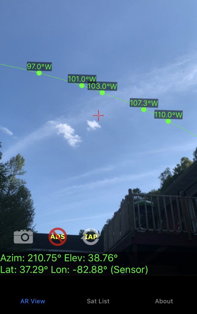

hi guys i today ordered new service from direct tv and I got the genie 2 and the wireless receivers. Install is set for Monday . I live in a hilly area and took this pic to see if this is the satellites I need for my service or am I not going be able get the signal. Also anyone have any pro or cons with the genie wireless? Thanks in advance!

You have a great view of the satellites! No worries there. Wired is always better than wireless, but you will probably be happy with the wireless version.

I hope I enjoy it lol. I was just trying to stay away from all the drilling in my new house. I’ve watched few videos and I’m hopeful it works halfway decent but also kinda wishing I didn’t go for the wireless. I’m sure their is some set backs . I was hoping I had decent signal, I got an app on apple store it’s not 100% but I guess it’s a good start, does direct use anything over the 110 satellite or is it mainly lower like 99. I apologize ahead for sounding crazy lol but I’m new to this stuff.

The only satellites you need to worry about are 99, 101, and 103. The international and Spanish programming is on the 95 and 119 respectively, but that is migrating to the reverse band. PR was on 110. All that means to you is that everything on Directv is available on those 3 satellites in some way.

The 99, 101, and 103 satellite slots are all that are necessary nowadays ...
95 and 119 are on the way out with all their programming already mirrored to 99 (on the Reverse Band or "99(cr)"). And 110 appears totally shutdown now, even in Puerto Rico which now uses 101 like everyone else.
