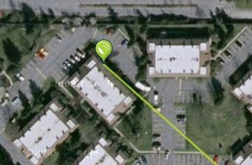

i found out on a website that shows you where to point your dish whit google maps.
Picture1.jpgThats 82.0 W. and more South is impossible from the balcony.
View attachment 27375Thats 82.0 W. and more South is impossible from the balcony.
So, a universal LNB would be recommended to get more channels?? Don't really care if Spanish or not, just know that i hate cable tv.
Looking at the Dishpointer picture, it seems you have a big clear roof at your disposal. And Flat too!!:eureka

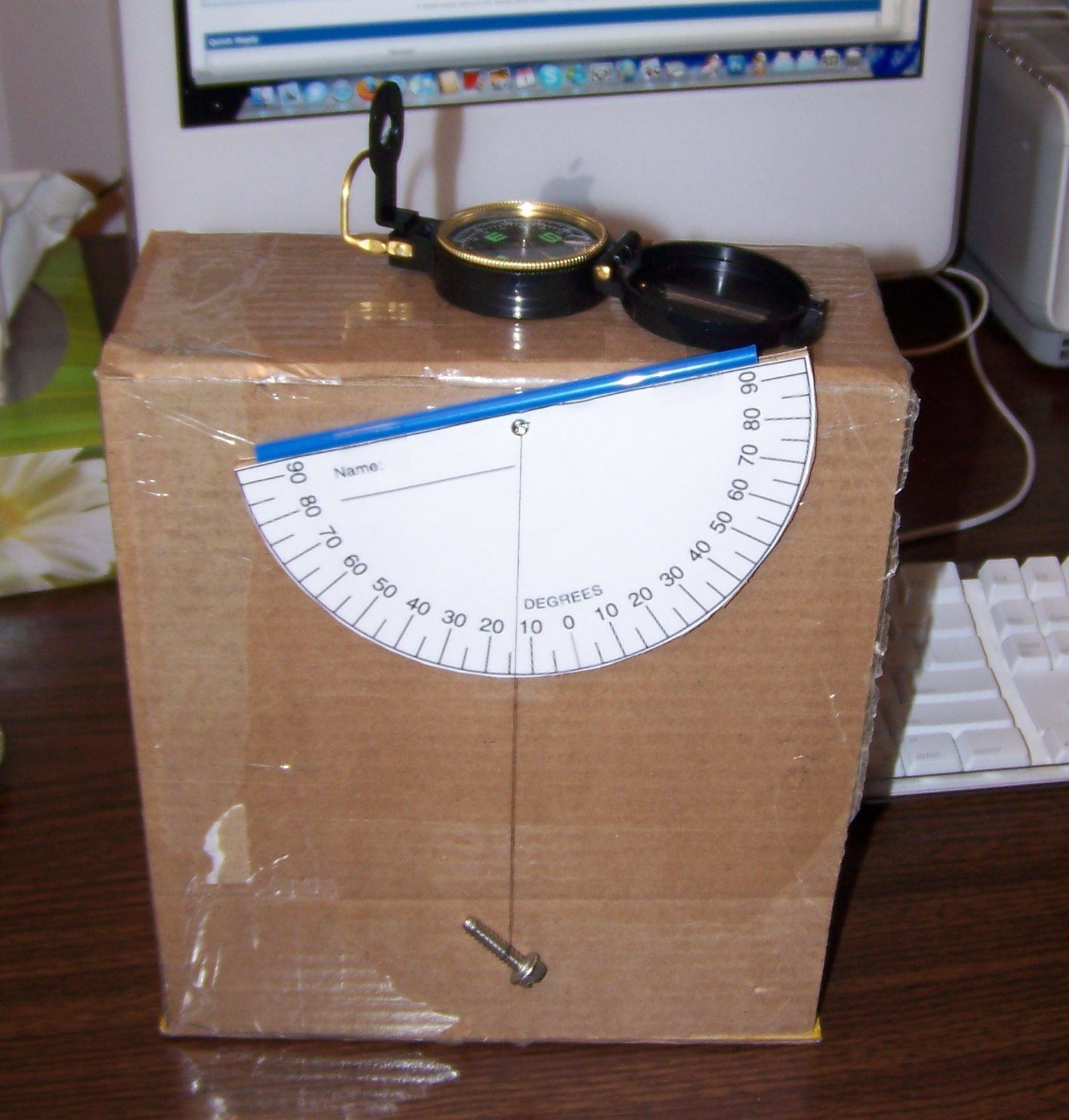

Ok Guys,
i made me an altered version of the Soda Straw Inclinometer. And here it is. Is it not awesome!! And yes i got a clear LOS!!!
