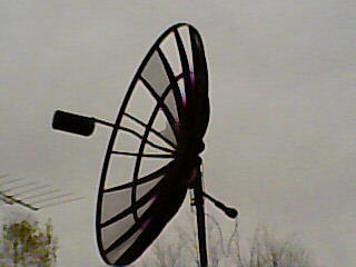

Found this 8(?)footer for free, just get it down. It's on top of about 15 feet of 3 1/2" pipe anchored to the front of the garage, so it's only 7 feet or so above the roof.
Any advice on getting it down?
Kind of an odd LNB mount, Nobody seems to have a clue as to brand.
Thanks, Eric

That one looks like it's in need of repair. I just listed a 'wanted' post on craigslist last night and have already gotten offers on four BUDs within 1 hour of my house. All free! On taken down already! You might want to pass on this one for now and look for an easier, nicer dish. Chances are that this one isn't going anywhere.

The feedhorn looks like it's on a pretty standard "button hook" mount.
They seem to sag some over years, and would need to be measured and possibly re-centered by stringing it with some metal fishing leader.
I went after a nice perforated dish up on 9' of pipe, earlier this year.
(My plan was to drop it in a 3' hole and still have the dish at the 6' level!) - ;)
We took the dish off the heavy AJAK H-H mount.
Could twist the mount on the pipe , but couldn't get it off.
Finally, we cut nearly all the way through the pipe down at ground level, but left about an inch.
Used a sawzall, then a hand grinder with a cut-off wheel.
We got all hands on deck, and bent the pole (at the 1" tab), and lowered the pole with mount attached, down to the ground.
The tab kept that end of the pole from flipping up into the air.
Use your own judgment, as to whether you want to follow a similar plan.
Personally, I'd bring down the pole, trash the dish, but keep the motor and feed for parts.
You can certainly find better dishes around, but poles don't grow on trees.
And digging them out of cement is real work! :rant:
