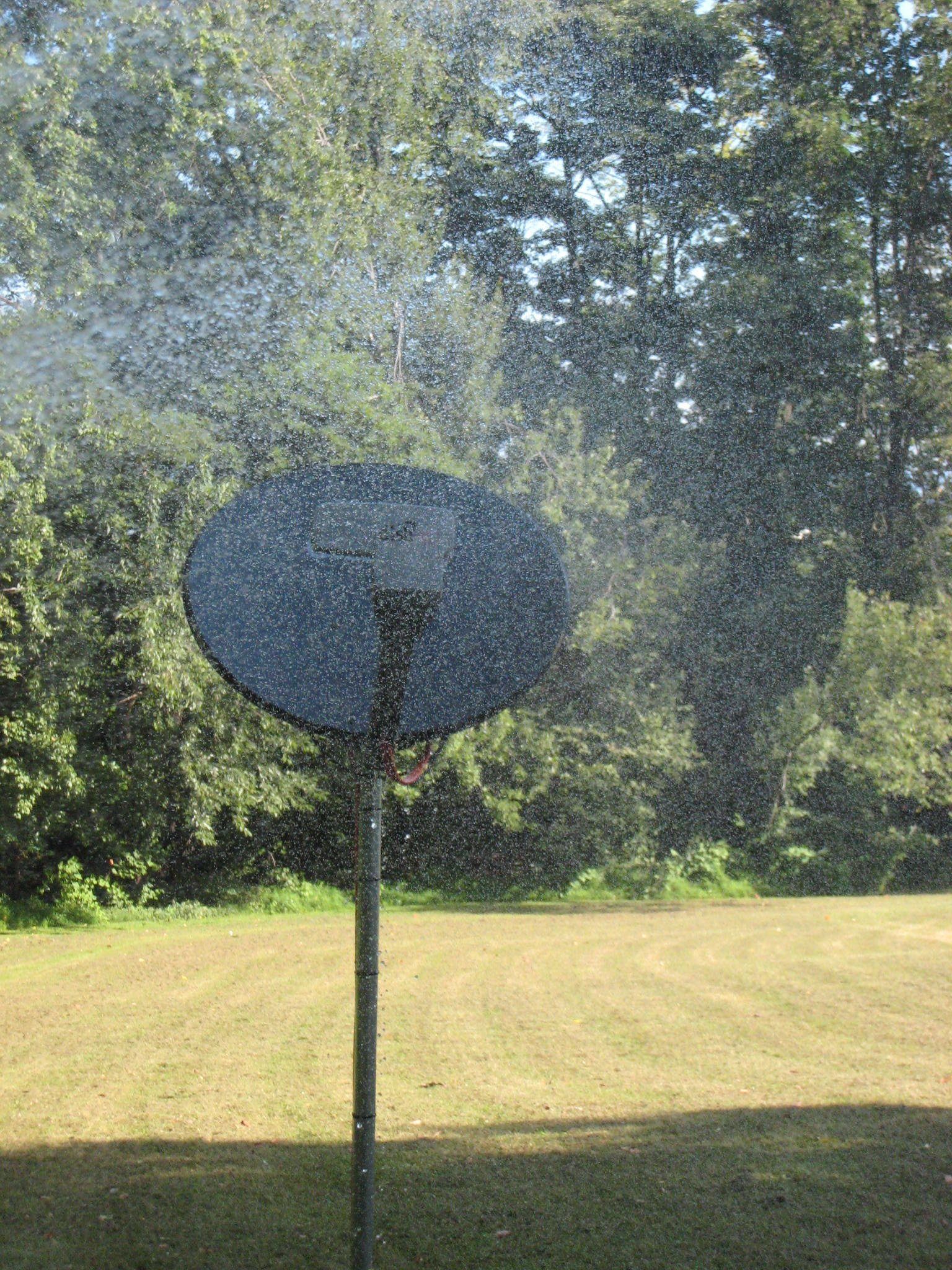

OK, I just did an experiment with my 3LNB EA pole mount dish. 61.5 sat, transponder 23. SS was 55-56 dry, dropped down to 53-54 when soaking dish with hose. The stream was directed over the LNB so the loss was probably maximized.
