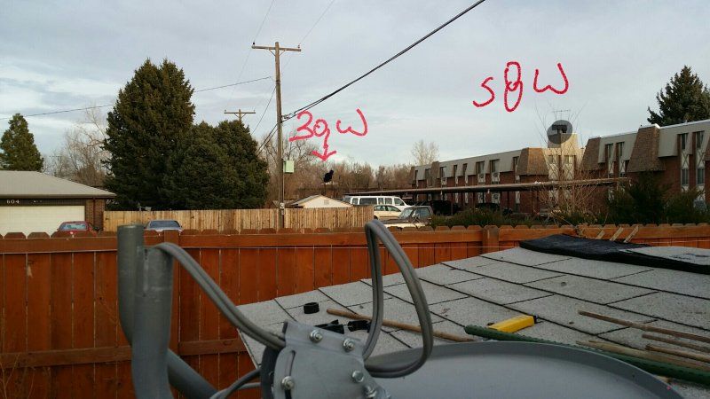

need strong dvb- transponder on 30w
offset on this dish is about 22-24 degrees. I was able to hit 58w KU inverted. Angle reader on the back read about 73 degrees.
still nothing on 30w. Its sitting so low in the sky I think its hitting the apt building about 200 yards to the east.
What I may end up trying is going somewhere where I have better line of site and seeing if I can hit her

This is my issue. 58w is sitting a little higher then what's marked in the photo. 30 west is sitting relatively accurate in that photo.
Is it at the black dot?
Doesn't look good, you would have to see 30W through the bushes....
I would check with the sun outage (or a few days before) at what location you have clear LoS to the satellite. I hope you have some options left for that...
