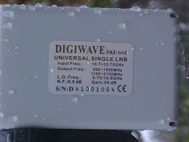

Was reading through Mark's post regarding the 22k setting for the lnb.
My Fortec LU greys out the on/off option when you select universal lnb.
Have gotten myself one of those little sat finder meters and have been out there in the rain today trying to get a signal. No luck.
Can anyone give me the settings for the lnb setup page for this bird, it's my closest true south sat.
Any suggestions?

a meter wont work with a universal LNB
If you have a spot for univarsal LNB, then it should work.

Thanks for the quick response Iceberg. Wish I'd known about it not working on ULNBs.
Any explantion for why the signal meter on this Fortec shows 50% no matter what, I literally panned the dish so that it was pointed at the roof and still got this signal. That's why I got the hand held unit.
The units will show a signal as long as something is hooked up to it.
Its quality that matters.
Honestly, aim the dish straight south and slowly start getting the elevation on the dish (not the motor...that is usually at 45 degrees).
Did you program in the info I posted above? It's easier to get a channel that way :)
The elevation on the motor depends on how north you are so it forms the right arc shape as it moves from H-to-H. :)
Yeh thanks, I did.
Need to know the other settings.
LNB = ???
Local freq = ???
22k = no option -- it's off with ULNB setting
DiSEqc = off no switches
TP = as per your post
Positioner = am using manual nudging
