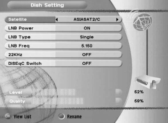

I remember Iceberg also mentioning LO. What is LO and where do I set it? I don't recall seeing anything on the setup menu called LO.
Gabshere: Oh yeah!! I think I understand what you mean when you say that you "set up a satellite for each...." That explains why I have two 116.8 satellites set up on my Coolsat 5000 receiver. One of them was probably set up for C and the other for Ku.
the LO is in the setup menu under dish ( for each satellite)
so from the menu
installation
dish setup LO is the second or third one on the list
LO for C band = 5150
LO for Ku = 10750
Huertaaj, it's labeled as 'LNB Freq' on the screen.

I believe there are two listed, as one is for linear (H or V) polarity, and the other is for Circular (C) polarity. Since the manufacturer (firmware engineers) didn't program a three way setup configuration for one bird, it may have been easier for the manufacturers to list the same SAT twice. Once for Linear and once again for Circular polarities. "C" would not be for C-band in this case.
The LNB needs to be setup for H, V, or C polarity. You select which one via the 22kHz switch controled by the receiver and the LO (local oscillator) settings. You are still receiving only one bird, but you have to program the receiver/LNB/switch for the correct polarity setup.
