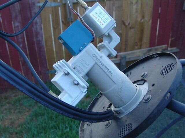

My friend gave me his Katrina dish, the pole was bent at the ground but the dish didn't lose any panels or slam to the ground - till the demolition guys knocked it down. I am happy and pleased to know he just bought all new C and Ku goodies before the storm, lifting up the cover revealed a nice setup.
Being completely broke with the exception of the stuff I am auctioning on ebay, I have managed to scoop up a couple old receivers, a positioner, and a new FTA receiver with blind scan and all the good stuff. I am EXTREMELY new to this, big time into electronics but a complete noob to this stuff.
I cememted the pole about 4 feet deep this time and put a huge mass of cement down there with it, its good and plumb. Now tell me, how do I get the dish onto the pole? Its above my roof top.
I am extremely inteested in receiving live feeds and interested in other stuff up there, just scanning the skies for the most part would keep me happy. By the way, the dish is one of those 8 foot mesh dishes.
Register to hide this ad
I am down here in the greater New Orleans area, nobody is open and I can't find cable for my bud to finish installing it - not to mention I still cant figure out how to get the dish up on the new pole way up there.
Help.. Consider I am broke too, Katrina took a lot from us including my job, money is critical.. Here is a picture of the LNB I have on my bud, note the cut cables.

They sell it for an outrageous price too, I have to worry more about putting food on the table down here for my kids and wife right now, i was hoping to find a place selling a 50 foot run rather a whole spool. I have a full box of RG6 QS but the other cabling for the mover and the servo are questionable, is there any way I can run some other type of cable such as cat5? I know the mover needs 16 g. but will cat5 work for the servos?
I have used telephone wire temporarily for servo wire so cat 5 should work even better...

I use cat-5 for both the servo and motor position sensor placed in a pipe in the ground. So far it has survived one Canadian winter and endless fiddling by me (I'm always trying to optimize things :D ). <Good> Professional installers would likely cringe if they saw it. I used it because I had a bunch left over from installing a network for a friend.

How much current is going to the mover motor? It is important because cat5 will burn up if its too much.
