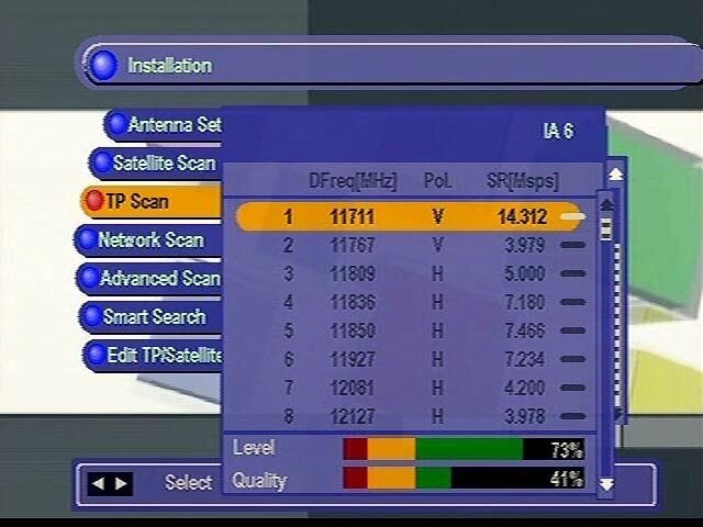

Maybe this will help. Here is a screen grab from the days when I had a Pansat 3500s. I believe the signal meter is the same. I live in NY state so it is a similar location as you. I use a 30 inch dish and an Invacom .3 LNB and here is what I got on IA 6 TP 11711-not great but good enough to lock on. I remember some signals in the 70's on some things. Compare this to what you are getting and it may give you a rough idea.
