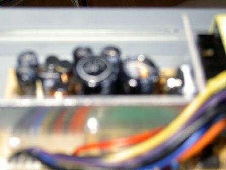

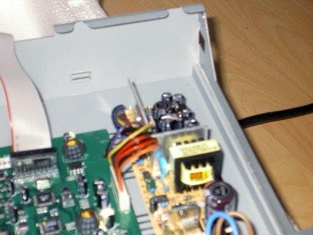

Yes I see two "big" black "things" (sorry electronics is not my major).
They are not flat like the others, they are round on the top where the cross it.
I took a picture but it is not very clear.
Here it is, hope this will help.

caps like most things have many ways of dieing, but rounded top is defn on of them, caps only have two leads and are usually pretty easy to replace. look on the side of them and they will have their rating in voltage and uF, goto an electronics parts store and they should have something to fix you up. if you go mailorder there are lots of places, like digikey.com, they have a $10 min so you'll probably end up ordering about 50 of each cap as caps arent very expensive.

Yea I think I see at least 2
I think I see at least 2 blown caps or one blown and the other buldged. If you take it into a eletronic store a real eletronic store. They can point out and make sure you get the right replacement caps or something very close in value.
Hard to tell one fuzzy pic and one shiney pic.

If its a power supply issue involving caps, I wouldn't be too worried about it. If the cap isn't flat on the top, 99 percent sure its dead. Replacing them is not a big issue.
Hello
I took it to an electronic ship this morning. The technician is sure that there are 2 not working. (tops are round).
So he will replace them. Will cost 4 $ for the pieces and 10 $ for work.
Hope this will work after that.
