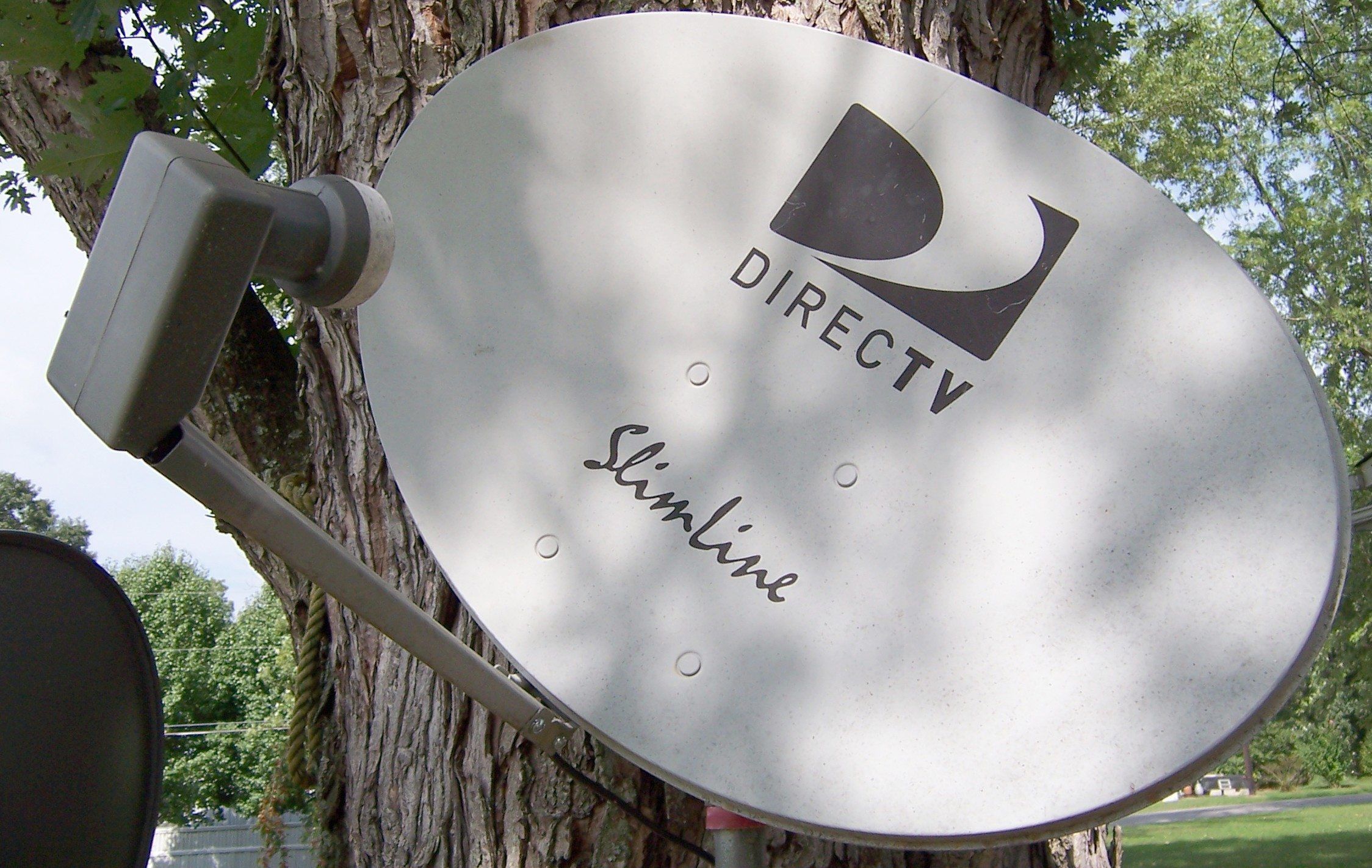

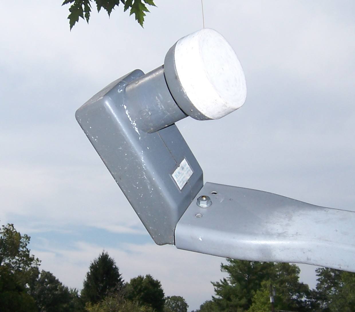

I used the DTV slimline(AU9) dish mounted on a J-pole and a linear dual output lnb made on the same style as the old DTV circular lnb's. You just have to drill one hole in the center end of the slimline lnb support arm and it will mount right up with the correct focal distance. I believe Sat AV still sells this lnb. If not, just try ebay and search for dual linear lnb. Will try to post a picture in a couple of days.
Platwound, here is the lnb that looks like the one I used. Sat AV calls it an SL-2 and his price is $15. If this image file doesn't come up, I will try again later with my own pics.:)

Thanks, squid, I know what LNBF you are talking about now. Is that dish the one with the micro-adjusters (for Ka-band)? Looking forward to your pics. :)

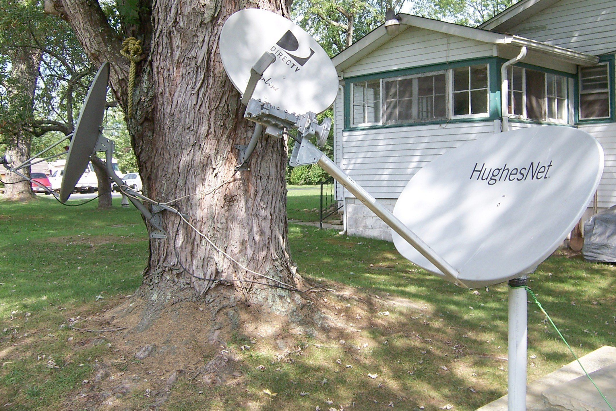

Yes, this is the one with the micro-adjusters. Don't laugh at my tree mounts. Hey, they work and provide a very solid mount. The old maple tree is about 3 feet in diameter.

Thanks for the pics, Larry, nice setup you have there. I never make fun of anything that works!
I do have that exact dish, that LNBF sure makes for a clean setup...I think Brian @ SatAv needs to have a closeout sale on that model, maybe 4 for the price of 2. ;)

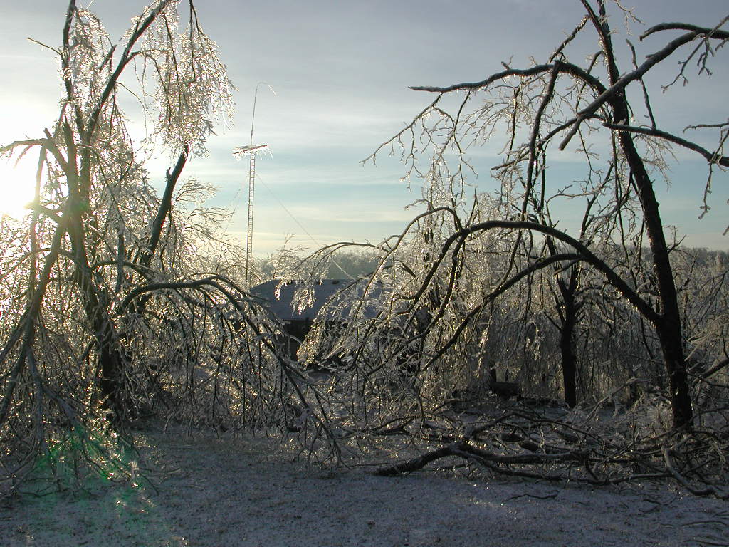

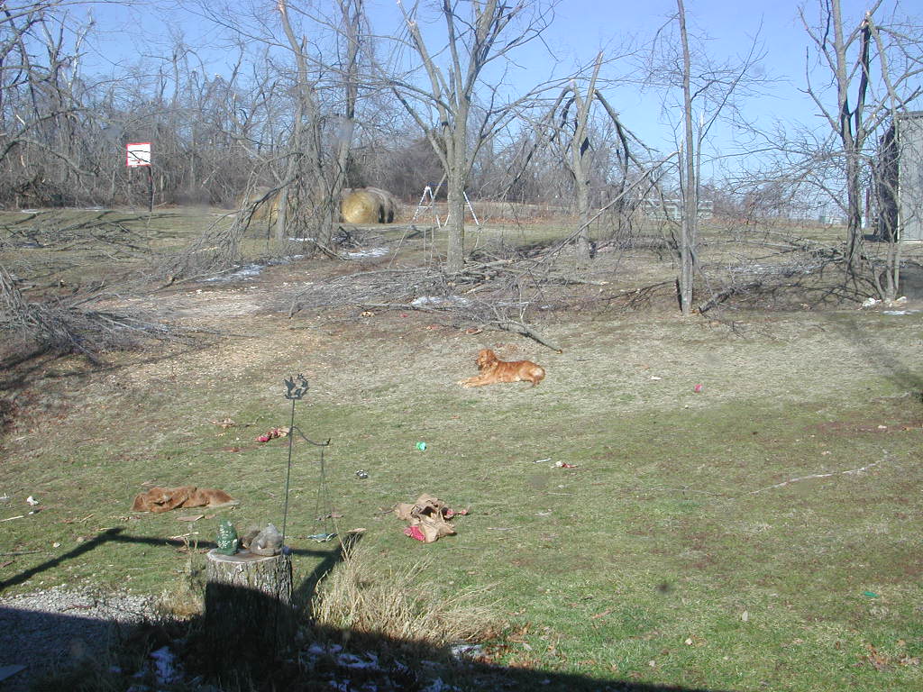

Is that a hard or soft maple? Probably wouldn't make much difference if you had an ice storm like we did in Jan 07, your dishes might have gotten a little scuffed. :eek:
