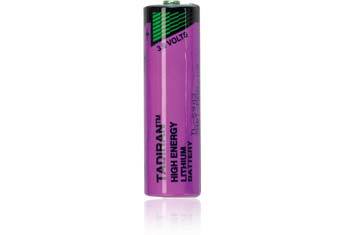

The battery would need to be changed in the gI one asap. The GI one most likely has a detachable cord and should have the two piece main board, later models have a permanent cord and a one piece board, GI most probably was made in the Philippines next level and Motorola were made in a few places.
anybody know off hand what battery the GI takes? i may need to buy one soon.
Thanks
Radio Shack sells a AA Lithium that some of us put in the 922 and in a AA 2 battery holder
for easy replacement by popping in another battery.
Check out the archives for install info!
Catalog# 23-940
Tadiran TL-5903/s
3.6V 2200mAh
Lithium backup battery
$16.99

Does anyone have a picture of this? I have read so many threads lately they are all running together... I could swear besides the TVROPO post of a direct battery relacement, that I have seen a thread about using a battery holder also?
I don't like holders since they can break from heat and the contacts can oxidize. Solder my friend is the best way to do it..
Okay, I'm almost convinced.... You're the expert. Since I already bought the Radio Shack #23-940 3.6V Lithium battery, I hope it's okay to use and solder in?
Most people are taking out the videocipher units and that helps to keep the units cooler.
Do you think that heat and oxidation pose such a great threat???
Plastic holders get brittle and crack from the pressure on them from the spring loaded battery terminals. If that happens bye bye 4D. Oxidation can cause the voltage to reduce because of resistance. If she drops enough bye bye 4D. I like solder :)
