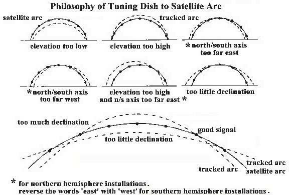

If you are using USALS to set up your motor, you should be able to lock onto the true south bird, then one satellite at each end of the arc, and the rest should fall into place.
If you are using diseqc 1.2 instead, then you are doing it the hard way and you'll have to save each satellite position individually.
hint: don't do it the hard way! - :rolleyes:
There is a table in the reference material showing an arc and whether you need to adjust your dish up/down/left/right to get a typical eastern bird.
Same for a western bird.
Using that info, you should be able to tweak the dish elevation and twist the motor mount on your pole to get aligned cleanly from east to west.
